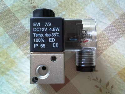

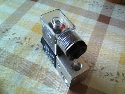

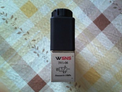

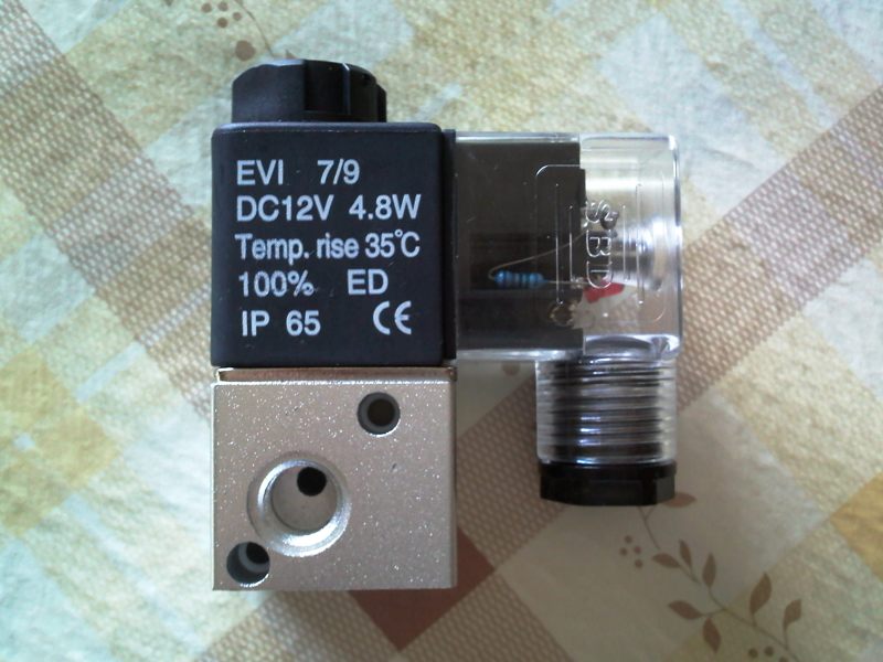

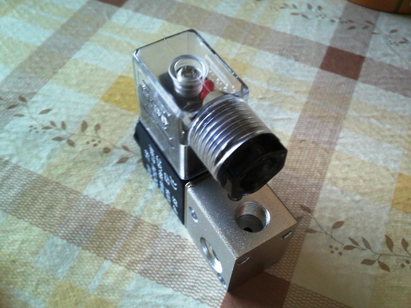

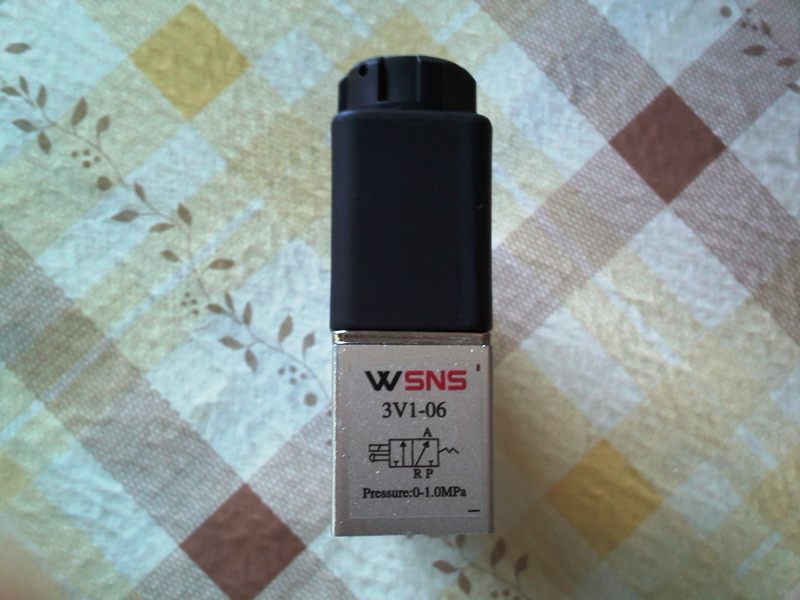

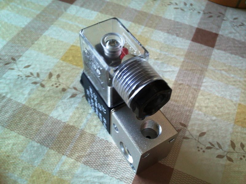

Hi is this a 3-way valve? when I bought it on ebay it says 3-way 2 position valve but it doesn´t looks like one to me :?
how many ports does it have?
warhead052
Posts: 1769
It looks like it has 3, I would say its a 3 way valve, but if you can't identify, there's only one other way to find out.
romicuraj
Posts: 6
Joined: Sat Mar 12, 2011 12:03 pm
http://www.solenoidvalvesuk.com/solenoidsymbols.asp
Edit: I think is a Two position, three way, normally closed push button
operated valve with spring return.
dewey-1
Posts: 1298
Location: NE Wisconsin USA
yup you're almost right...
It is a 2 position, 3 way, normally closed solenoid valve with spring return (and a manual overide - I can't see a button or lever there but the symbol suggest that there is one somewhere (maybe the screw on top of acts as it)
@wyz
make sure it has 3 threaded ports
it is very likely that it has one of the ports on the top (under the cap) if that third port isn't threaded you can use it as an universal valve (one that can be used either as a NO and NC valve)
EDIT
yup, it has its third port there >>
http://www.stcvalve.com/STC-DOWNLOAD/SOP-2V025.pdf
ohh and wyz put more pics of it and test it - I am acctualy considering getting a 2 way version of them and I found them for like 9$
al-xg
Great Britain
Posts: 643
Does that little hole in the sides ports go right through ?
The air-tac ones do, which makes them useless.
wyz2285
Austria
Posts: 2390
Location: Porto, Portugal
Yes!!! DAMN!!!!
I will have to tap one side and use it as a super lame solenoid valve :( :evil:
uhmm what do you mean by that?? I assume it has something to do with the fact that they can be used in manifolds but I just want to be sure I get you right
