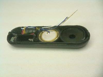

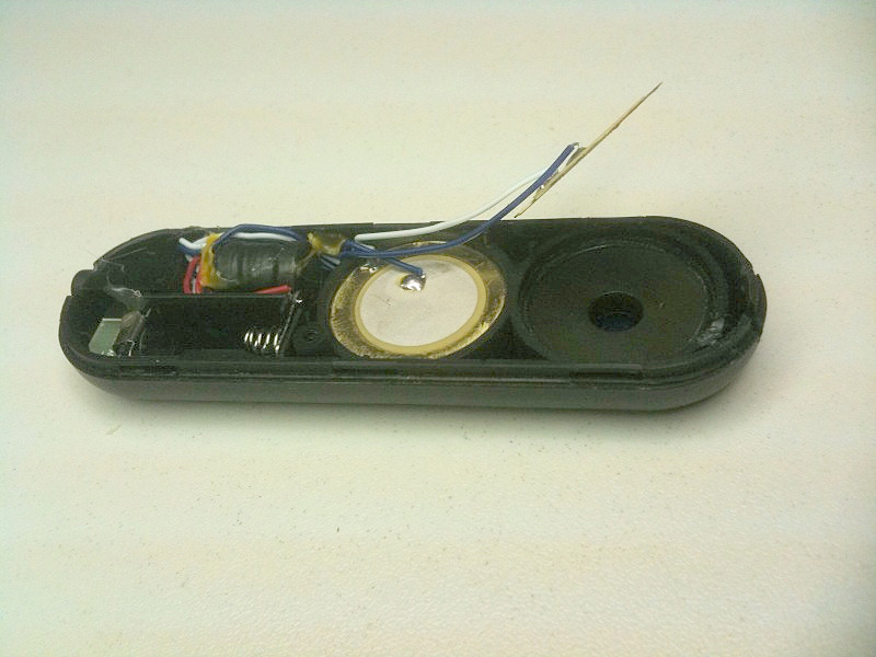

I've open the alarm, I was hoping that the internal would be a narrow circuit board with everything attached to it, but no luck. The piezo are 20mm diameter which would need a minimum diameter 1" (25mm) to accommodate them. And the resonance chamber is part of the plastic casing. That plus the fact the piezo might not survive the Gs as previously stated, I don't think it worth the try for now.

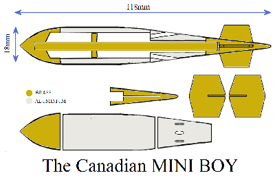

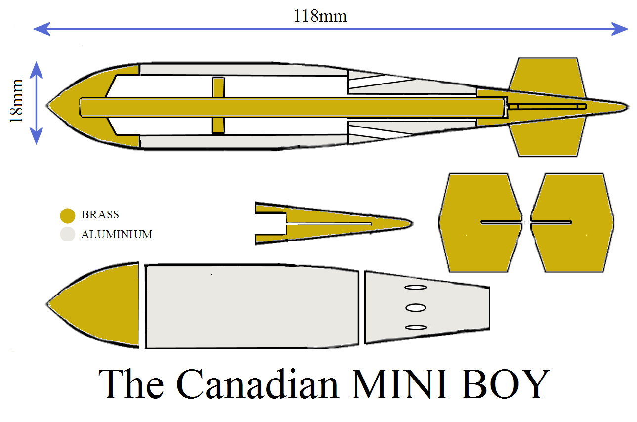

I have redesigned the missile to keep it around 20mm diameter, and simplified a bit the machining operations. Things will be kept together by a threaded rod (brass or steel), with a large nut/spacer in the middle to be able to make 2 adjustable chambers. The front for some weight, the back for whatever you like ;-) I'll drill small holes around at an angle for possible oxygen intake/exhaust so the drag should be minimum.
Unless someone share some better idea, I hope this weekend I'll make some metal chips :D

The idea was to make an ammo small, heavy and aerodynamic to reach maximum range. After filling my MiniBoy with pieces of tungsten... not sure if there will be any room left. If you plan for a bigger ammo... then what about the small and heavy idea for a better range?
