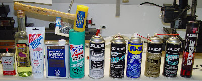

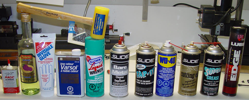

I bought some for aluminum... my wife can't stand the smellI would use a cutting oil, like TapMatic (smell s great)
I didn't use cutting oil for brass. I usually don't. Just to avoid the mess around. Machining slowly seem to provide nice enough results. Usually I use lubricant on brass for slitting/slicing/threading only.
I had some good result with LPS lube edge wax bar. No smell, no mess, and work well enough for slicing (I just put some wax at the cutting edges).

The stuff for aluminum is completely different; it comes (or came) in a silver can. The stuff in the metal gold can is for "everything except aluminum" and has an almost sweet smell. It's an old formula; I don't think it's available anymore.LeMaudit wrote:I bought some for aluminum... my wife can't stand the smellI would use a cutting oil, like TapMatic (smell s great)I also thought the odor what not that bad... women...

For fun here's my personal collection of chemicals (there's an out of place item in the picture)

Hammer!!!LeMaudit wrote:For fun here's my personal collection of chemicals (there's an out of place item in the picture.

Hmmm, need to go shopping.here's my personal collection of chemicals (there's an out of place item in the picture)
