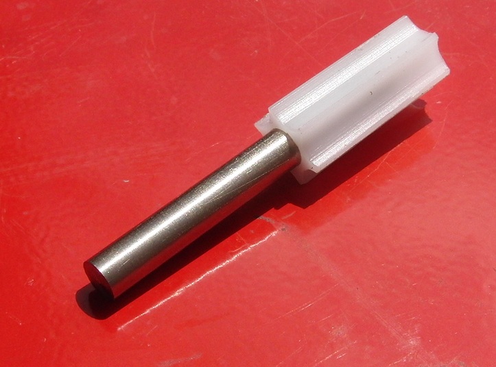

In fact, the round tungsten have been sent!
I look forward to receiving them
Posts: 26220
Been thanked: 352 times
Petitlu wrote:In fact, the round tungsten have been sent!
Here's the first of the fins for those rods, made with a little more care :)
Petitlu
Posts: 807
Joined: Fri Jun 03, 2011 4:52 am
Excellent! you are my god! :D
the round completely through the fin?
