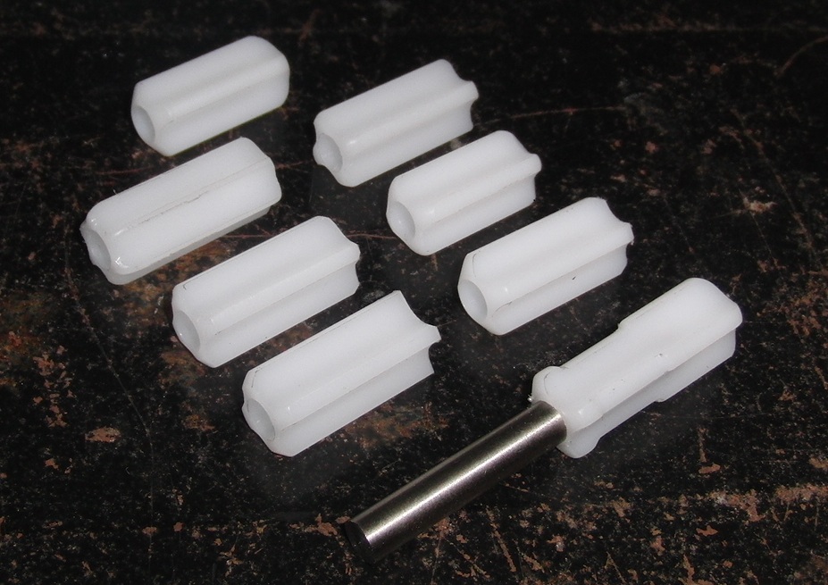

Hybrid ThorJack
Petitlu wrote:the round completely through the fin?
No, the length of the fin is 28mm but the hole is 20mm, keeps the centre of gravity a bit more forward :)

You know the weight of the tungsten rod?
Petitlu wrote:You know the weight of the tungsten rod?
Should be around 22 grams, I definitely would not want to stand in the way of this thing :shock:

Based of the performance of the SP-6 round I mentioned earlier, I'm quite confident you will have full penetration. What velocity does HGDT predict?

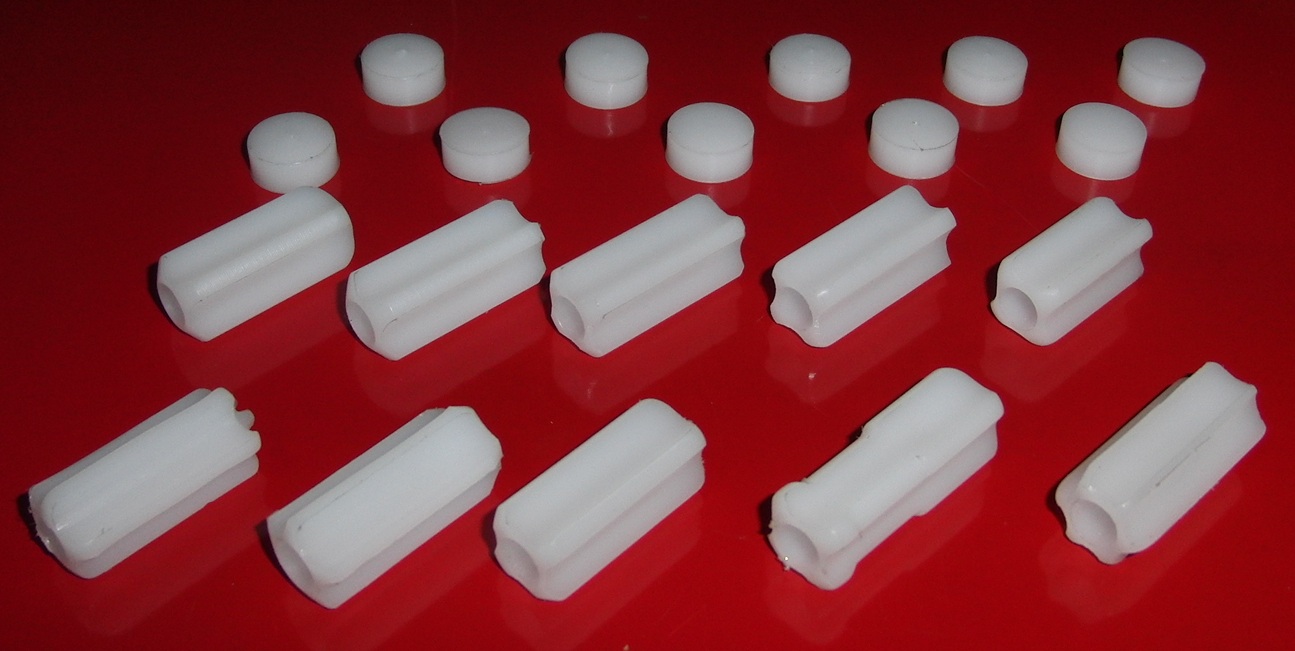

Here's what I made so far, a couple of variations because I'm not a CNC machine and making 10 exact copies of the same thing would get boring ;)

Nice work !

it how long you need to make a fin?
Petitlu wrote:it how long you need to make a fin?
I timed the manufacture of fin N<sup>o.</sup> 10, it took me 15 minutes from cutting the delrin rod to the finished product.
All that's left now is the pusher plates.

In the meantime, tungsten carbide rod fins and pusher plates done ;) much happier with these than the rough cut first ones I sent you.

Yes they are very pretty!
