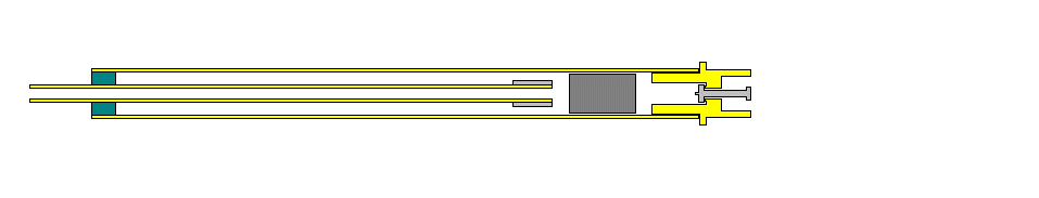

If you're having trouble understanding the function of it, read this.
It's just a co-axial piston valve on a very small scale. The schrader valve allows pressurization and triggering.

how do you pressurize such a small thing?
nath64 wrote:how do you pressurize such a small thing?
I know it's a long thread but if you bother reading through it I'm sure most of your questions will be answered.

Edit: I really can't put how it works any clearer:
