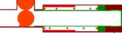

I've been thinking about the design and perhaps it would be best to use a compression spring to return the bolt, as this configuration would be easier t otune - this would make it practically identical to the breech clide used in his GB semi, so much so that I can adapt his animation of the said launcher to illustrate what I had in mind:

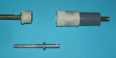

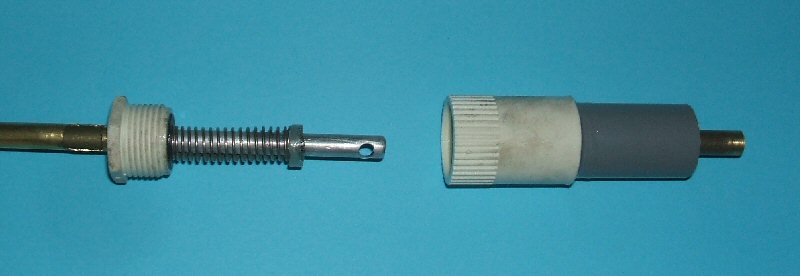

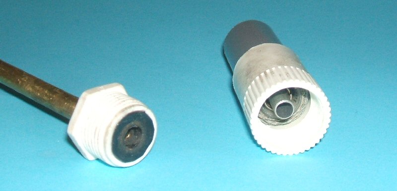

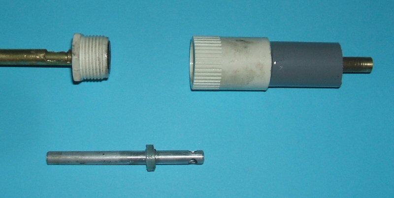

edit: here's some pics of the prototype while I wait for the epoxy to cure completely.
edit 2: Well, I've been testing the thing all afternoon and in spite of playing with spring strengths and addind lead weight to the bolt, still the same effect as before - either it cycles furiously sounding like an angry wasp, or it doesn't cycle at all.
In conclusion, I don't think any amount of tuning is going to make it work with a constant flow of air at compressor pressures. Next step is to see what sort of performance it gives with single shots, to see if it's worth making a "pulsed" air supply like this.
rear section removed, with bolt held in "rest" position by spring
end view of the two sections, with the bolt and spring in the rear section
Prototype in disassembled form, from left to right barrel section with ammunition feed slot and rubber damper in male thread, bolt section with cast epoxy stopper and rear section with brass tube air feed that also doubles as a bolt housing
