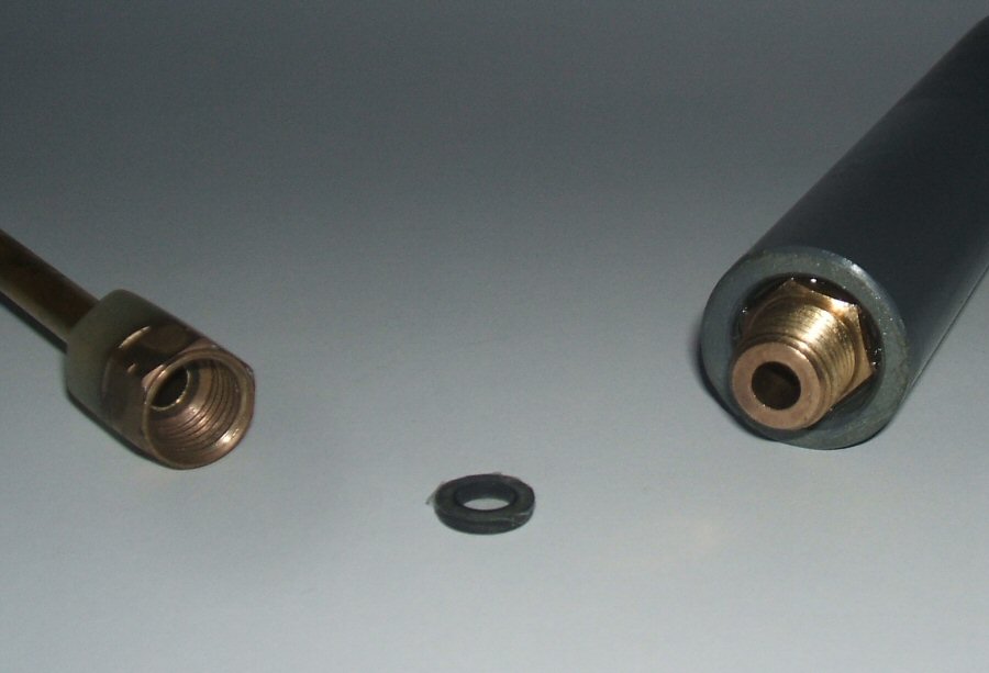

how are you using tape as a burst disk? can you demonstrate in any way?
very easy, in between the fittings I put a rubber washer and a disk of tape, I'll post photos when I'm home.

In response to this earlier question:
I attached a pic of the firing setup, with the rubber seal covered with the transparent tape disc between the barrel and the chamber.
