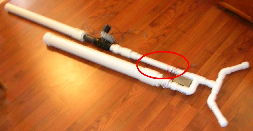

hubb017 wrote:I agree with windshrike on the stock. Maybe make all the fittings flush with each other, like this.
As far as configuration goes, I personally like the barrel longer than the chamber. I would also keep the valve as close to the ammo as possible to eliminate deadspace. Also, in that third picture (the one I am suggesting) you should take away that smaller pipe from behind the valve.
Hmm...If I did that design, I think I'd have to make the gun lonjger width wise...I'll try it out and see how it looks. About that small peice of pipe behind the valve...It connects my male adaptor to the bushing that I'm using so I cant really eliminate it...
And I'm not sure I understand what you're saying windshrike...
Thanks for your help!

Okay, check out the pics. Maybe they will make more sense.
You should shorten this part.
Don't change your design.  Just use the stock part.  Shorten the pieces of pipe in between the fittings.

Here's how it looks with the mods you suggested:
Better?
Hubb
Posts: 2390
Location: South Georgia
Now that's a cannon :)

hubb017 wrote:Now that's a cannon :)
Standby for that program. It was threaded not too long ago. I'll try to find it again but you may can search for it.

Also is is tokay for me to be tapping a hole in my endcap?...I tried testing drilliing one on some of my extra PVC I had left over, but it was WAY too hard to hold it still so I figured use the endcap....is that okay to do?
windshrike
Posts: 178
Joined: Thu Jun 28, 2007 4:23 pm
Sure; just be sure to use lots of teflon tape or sealant when putting in the fitting.

Yea, your cooking with gas now. It's going to be alot easier to handle configured like it is now. Next pictures you post should be of something getting blown to bits and pieces :twisted: !

I like the look you have gotten to now. One note, if youare planning on modding that valve in the future, you might want to consider if the blowgun will be mounted straight out of the valve or if you are going to use some air hose.
If straight to blowgun you will want to compensate for the space for the blowgun since you have a nice compact design. The easiest way is to make it so the chamber sits offset from the barrel and the blowgun can come basically straight down. It will keep you nice compact look. Adjust the stock part so the chamber is rotated just an inch or so away from your dominant (trigger pulling) hand.
If using an air hose you shouldn't have any problems since you can run airhose all day long to get where you want the gun to be.
Looks awesome. I can't wait to see it all painted up.
BTW if that is the Rainbird jar top valve, you will probably want to follow my mod program for Rainbird's (they a bit different from Orbits). I used a different valve, but the procedure is basically the same just ports are in different places. You can find it here http://www.spudfiles.com/forums/pnemati ... 10489.html.

williamfeldmann wrote:I like the look you have gotten to now. One note, if youare planning on modding that valve in the future, you might want to consider if the blowgun will be mounted straight out of the valve or if you are going to use some air hose.
[/b]
Thanks! If and when I do mod it, I will most likely use a hose(because there doesnt seem like there's any point NOT to), so it shouldnt be a problem.... The only thing I have left to do now is fix up a paint job.... Anyone have any suggestions? :D
