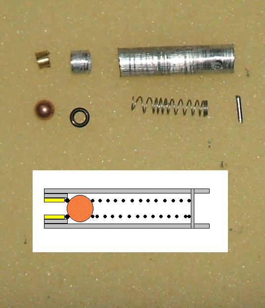

The spring is between the bolt and the barrel, it's not drawn in the diagram but you can see it in the animation.

I just finished making the check valve unit, I could have used a schrader but I thought I might as well make my own
rather fiddly to put together but the result is great.

That's awesome JSR it will most likely work is that a marble that you are using in the poppet valve or is it a ball barring? To tell you the truth I was thinking of the same design for a poppet valve. Nice work!
It's a 4.5mm BB, what strafer lovers call "ammo"Is that a marble that you are using in the poppet valve or is it a ball bearing?

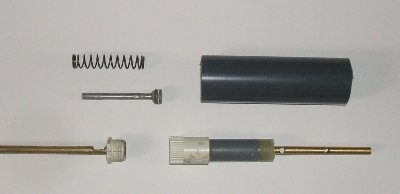

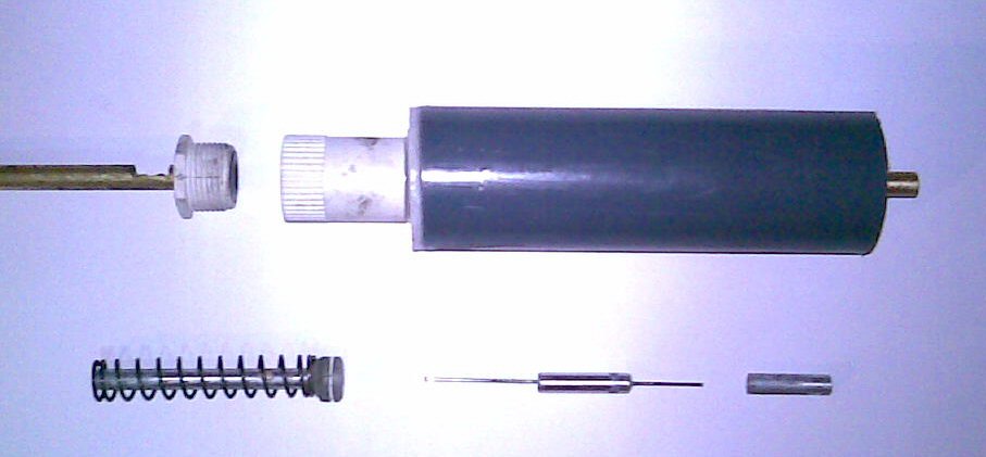

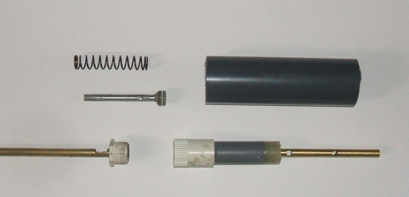

Here are the parts before I fit the step and epoxy the valve in place. An old friend is visiting from the UK, meaning we have a lovely booze-up planned for tonight so I can't guarantee test results in the morning, but I will bring them to you as soon as I'm sufficiently conscious.

wow JSR that poppet valve is MUCH smaller than i thought it was... .177 cal bb as the ball? wow..... are you sure you will fill the chamber up fast enough with that?
anyway, that is looking S**T hot...... the finished product will be much better im sure.
