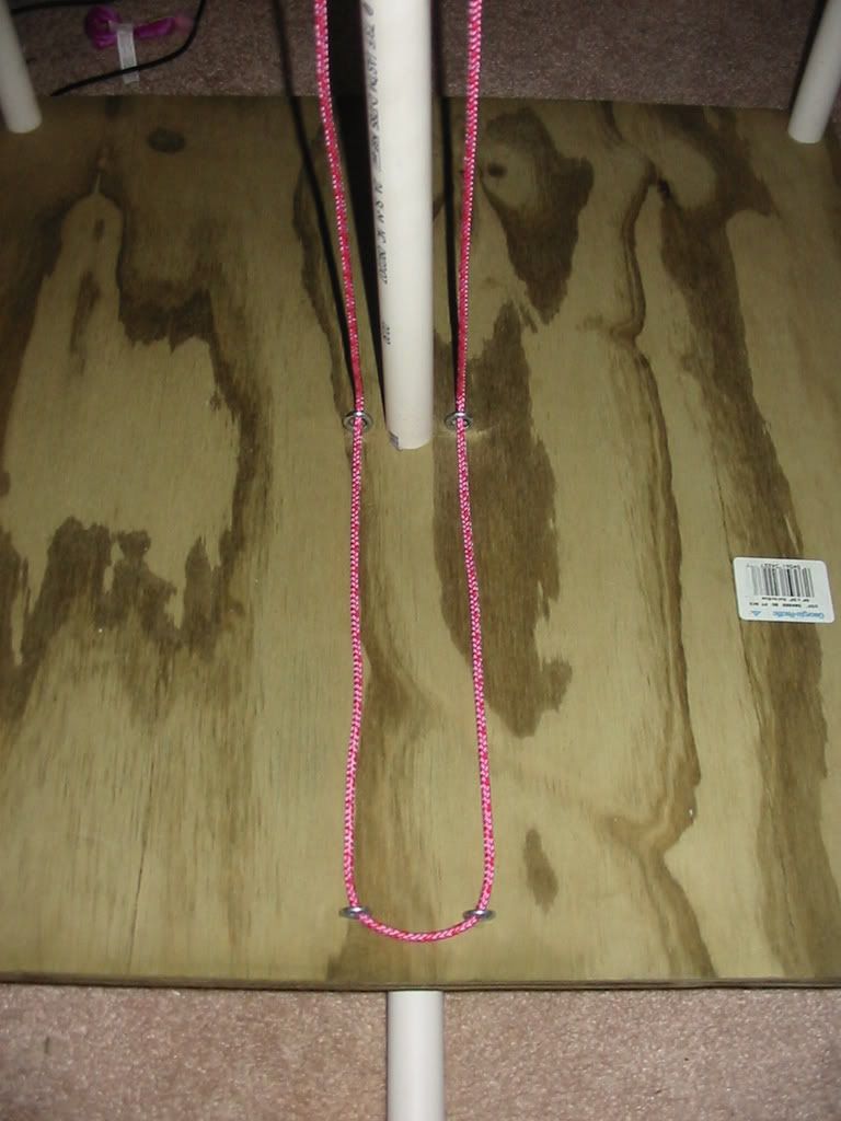

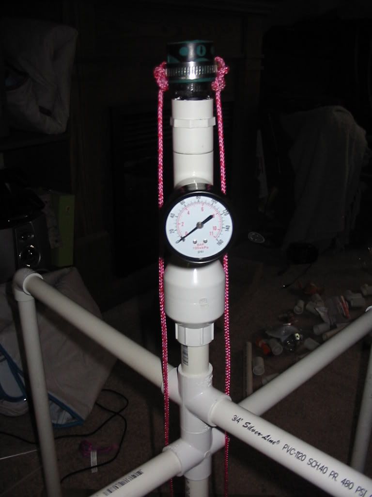

cool scott, can you explain your release system? I need to build one simlar so I can test my rockets and beat every one at school
- scottcrete
- Posts: 332
- Joined: Tue Mar 18, 2008 1:26 am
- Location: Bridgeport, West Virginia USA
look closely at the pictures .... you will see that....
A.
the pulley system for the rope.. you want to hook like a leash or something at the front where the rope makes a u between the two eye hooks
B.
you can see how it connects to the quick connect.. by the means of a hose clamp.. this way when you pull on the rope.. FIGURE A
you will put equal pressure on it.. making it pull down and release the rocket.
