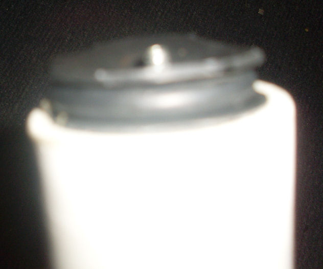

Well there was some initial teething problems, but I think I got it sorted out, the main problem that I took a while to work out was that the piston didnt have a very big washer on the sealing face so the sealing face manged to get itself folded and cut under the pressure, I put a larger washer on and some thicker neoprene and it seems to be working well now. Im still yet to go above 30PSI cos it was so loud but when I get a chance when no ones around I'll hopefully be able to get some videos at 100PSI

The problems I have now are; I need to find a massive washer for the piston cos the pressure keeps bending the sealing face, I put a very thin washer on that was quite big and the pressure folded it in on itself after one shot
Also the sprinkler is leaking quite a bit from the exhaust side of it, maybe the hose clamps or are slowly leaking and making the diaphragm seal leak, I'm not sure, hopefully the seal is just dirty or something.

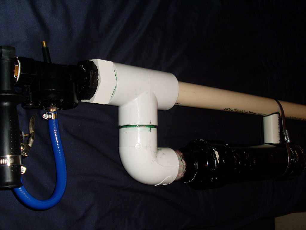

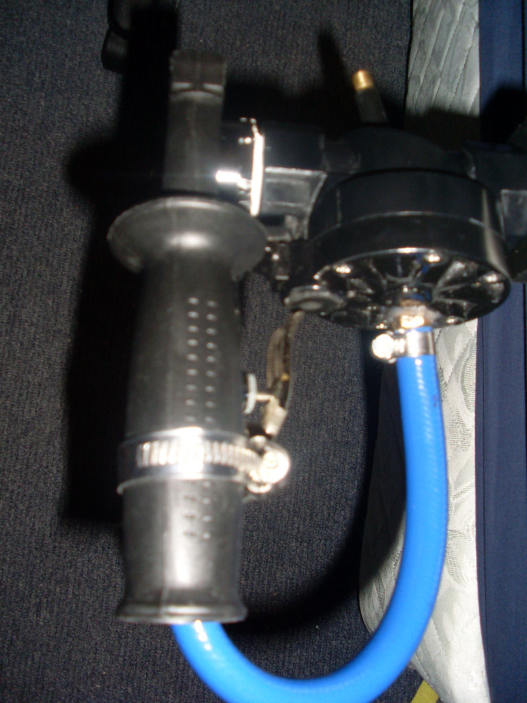

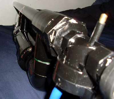

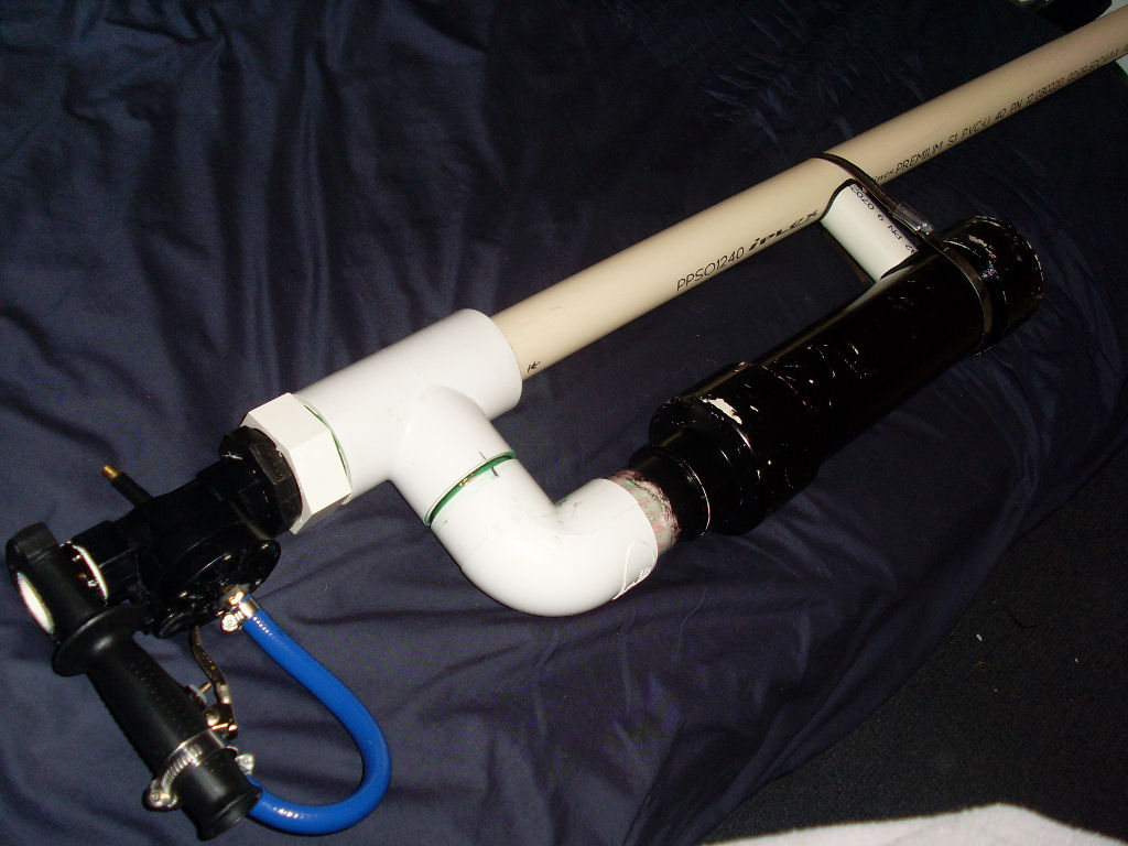

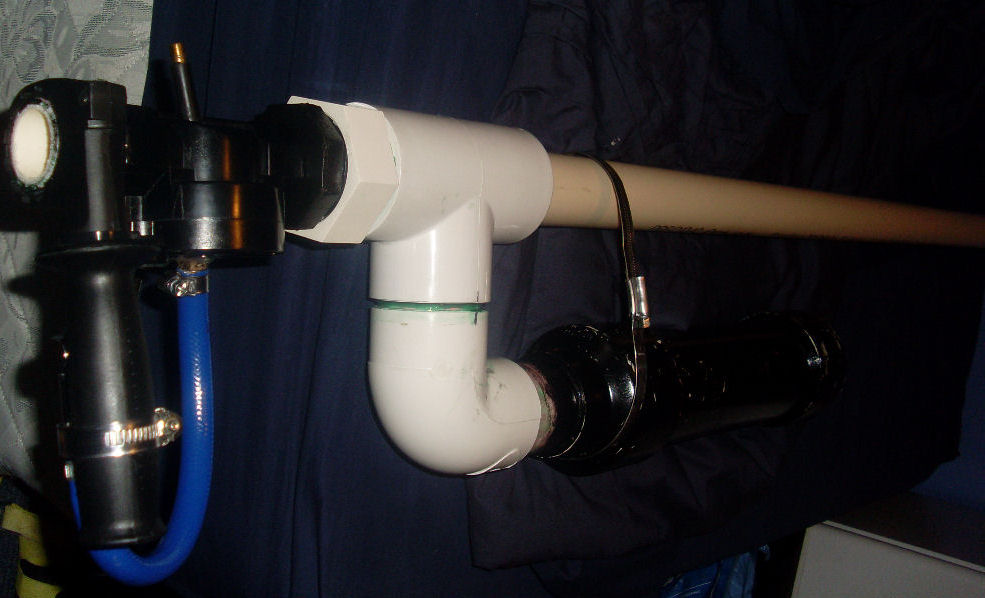

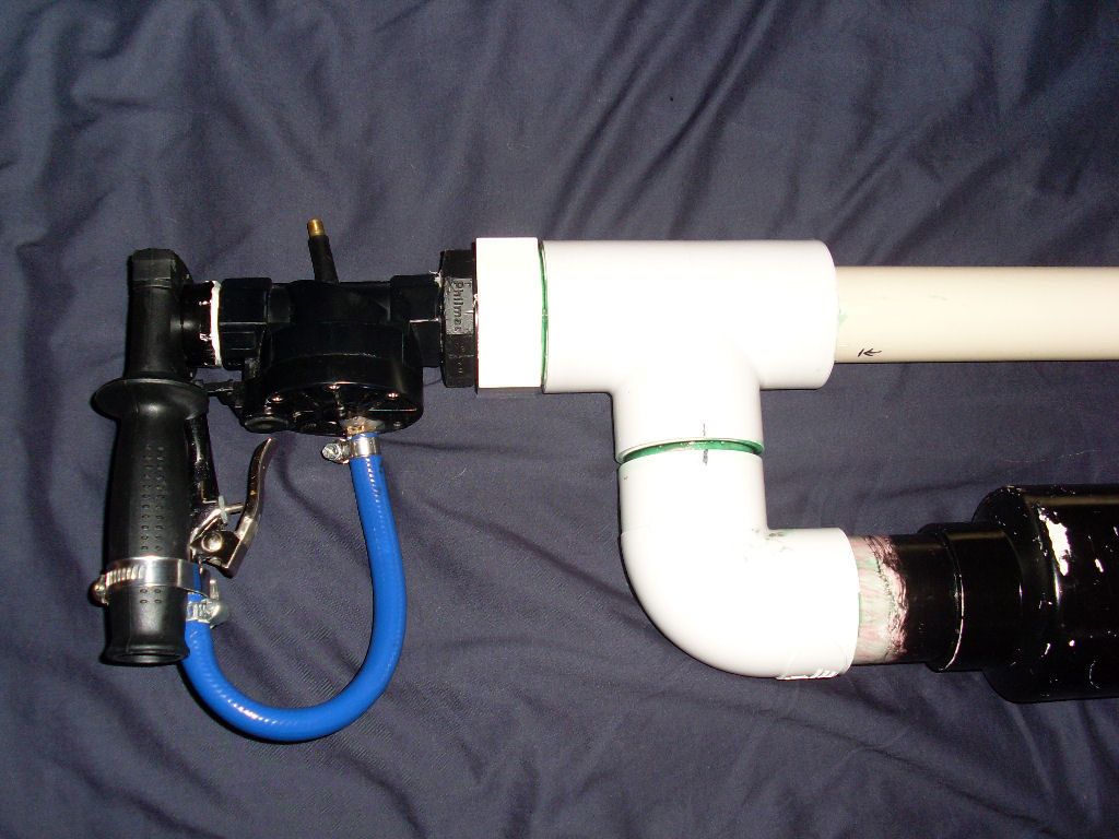

Ok heres what it looks like so far, haven't done the barrel support yet or painted

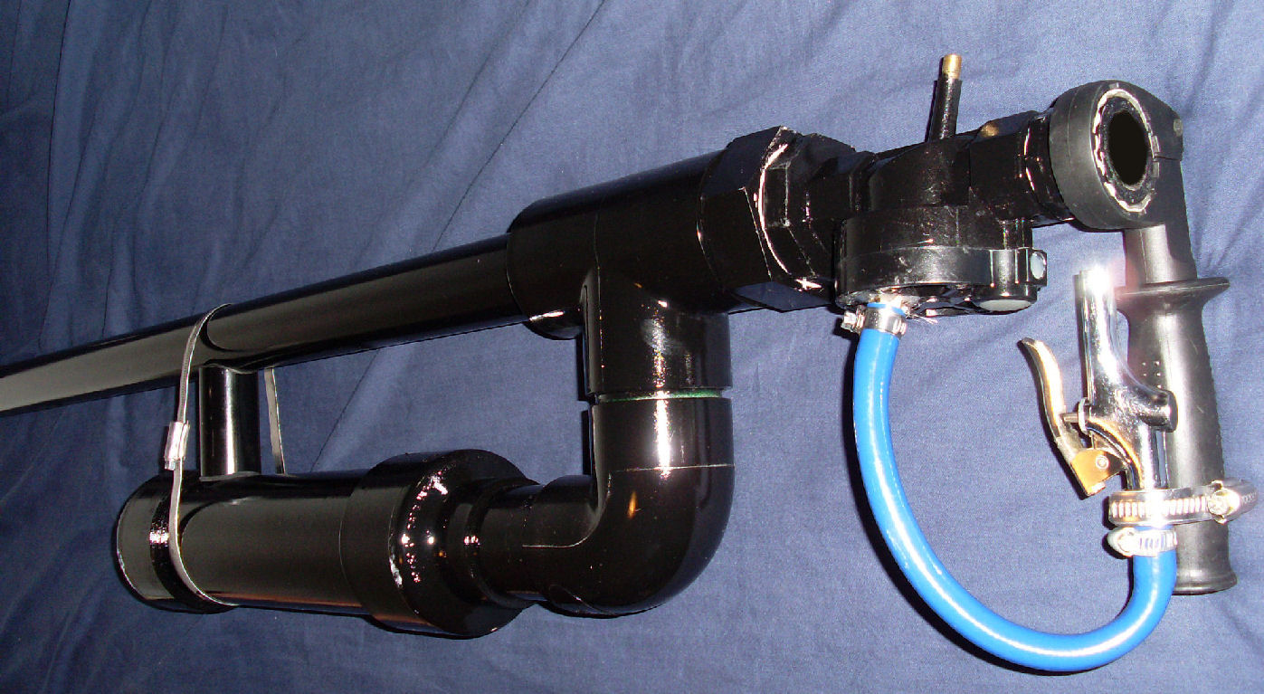

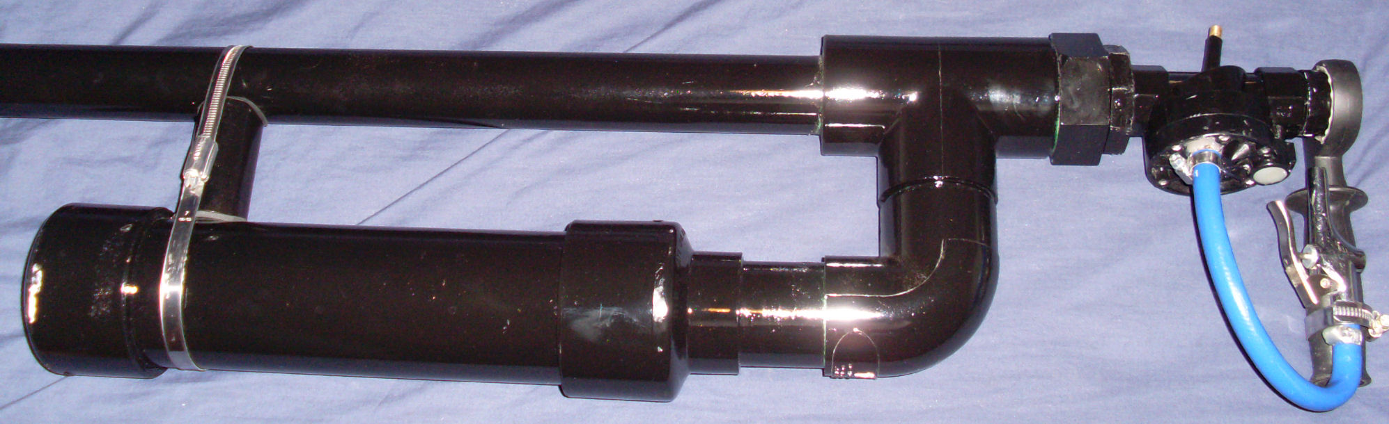

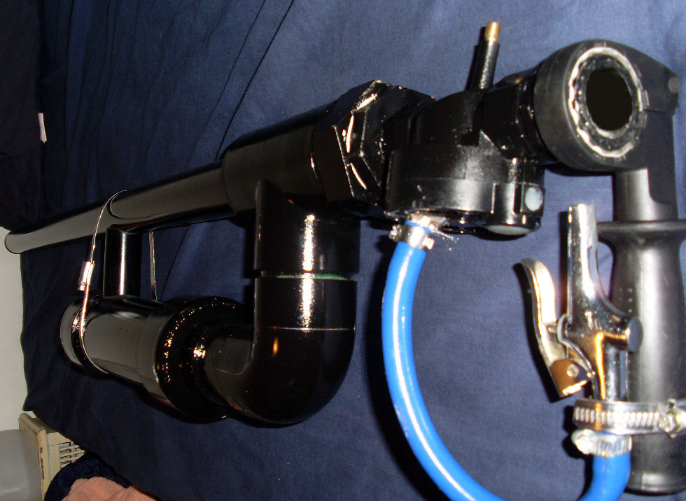

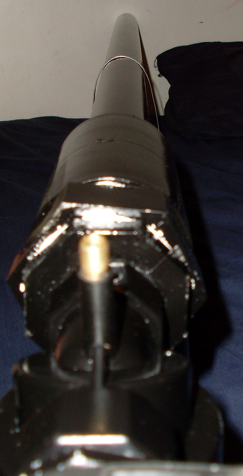

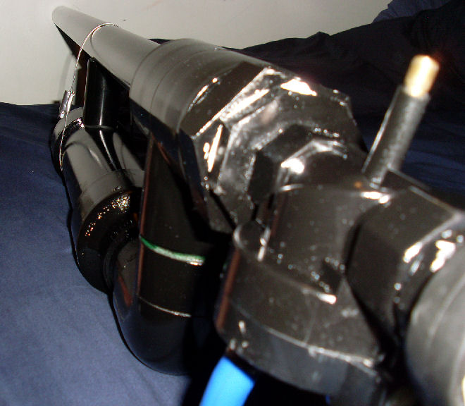

Glossy!!! A nice paint job for the paint-stripping gun.
