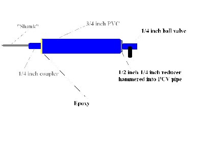

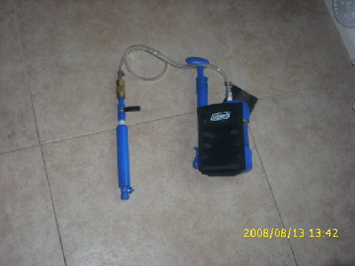

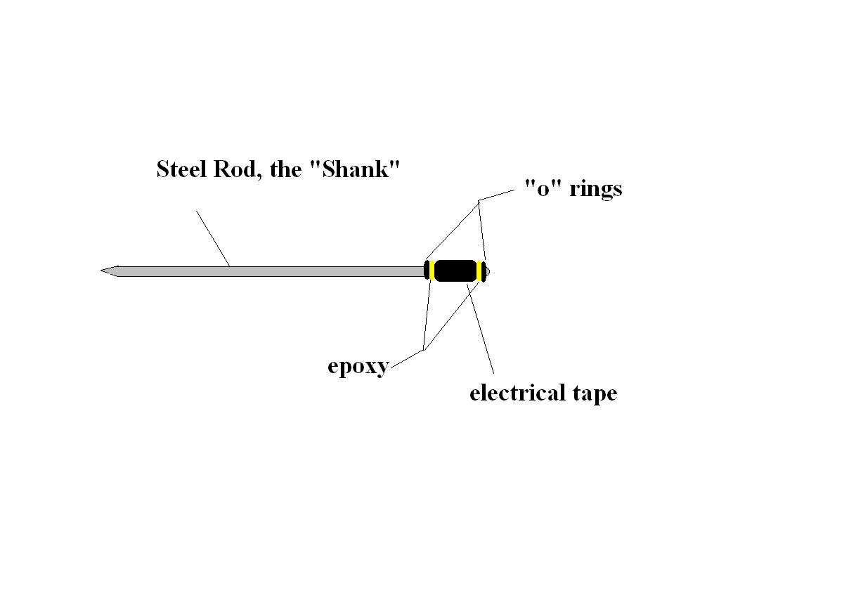

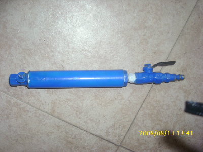

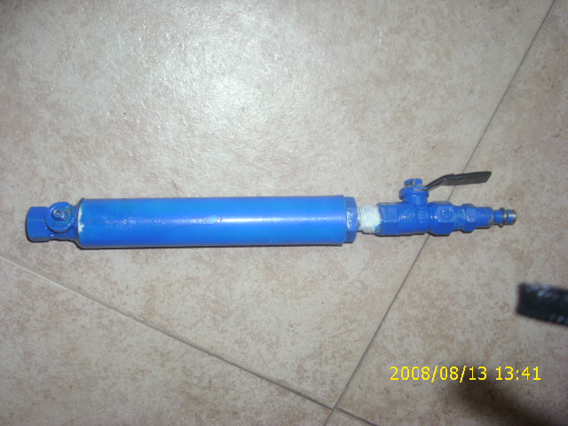

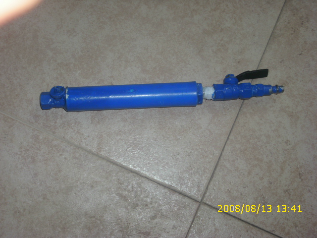

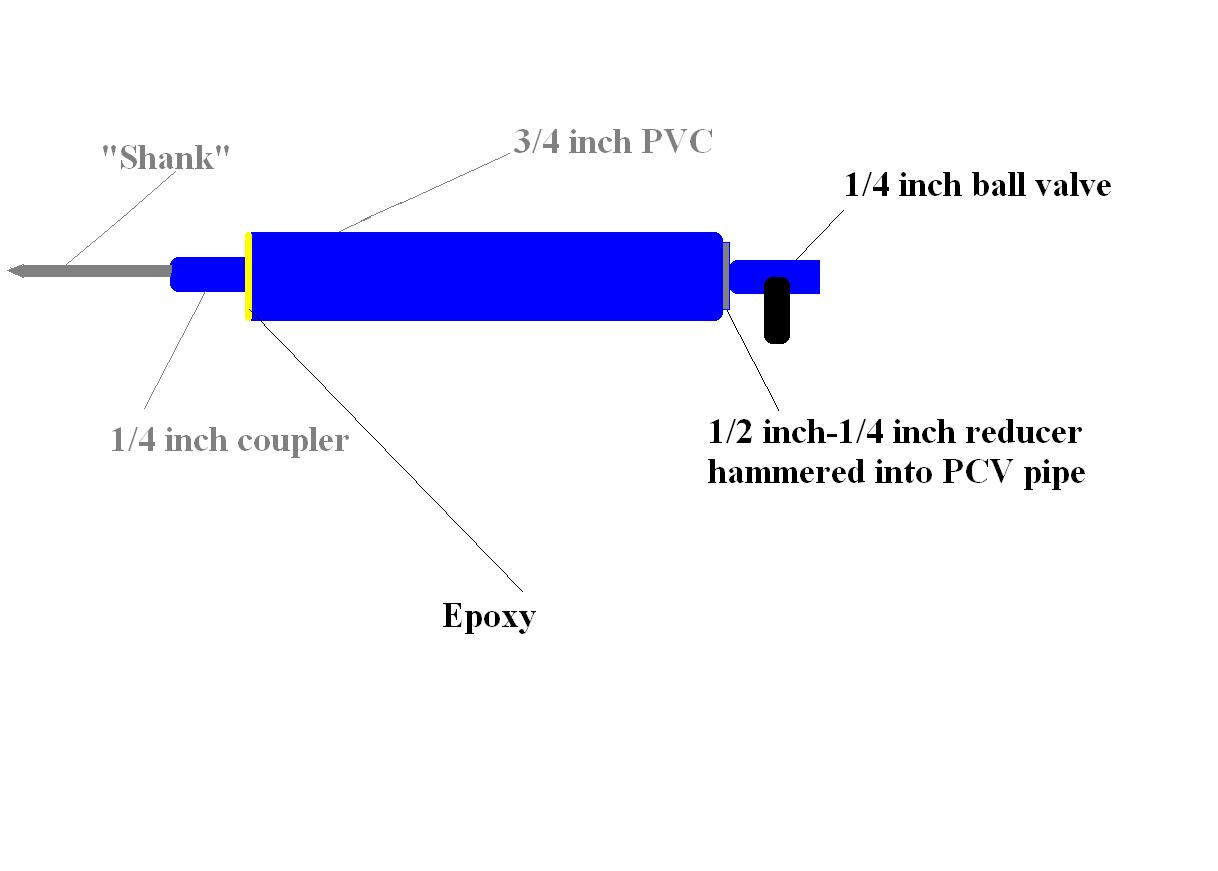

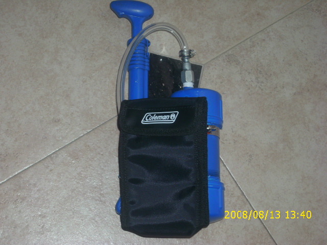

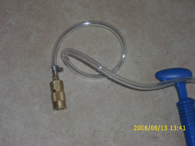

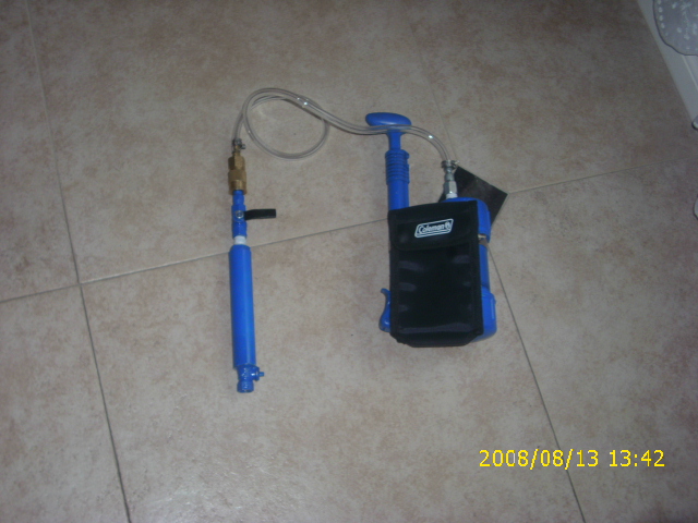

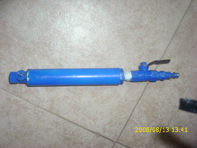

Here is the newer version, IMO, its much, much cleaner, and just as deadly, but less air efficeint. the cylinder is 3/4 inch, same shank, just a larger piston, and I added a Coleman Pouch to my air setup to store the 3 foot hose.

Wow Frank, thats pretty nice, Are those lathed fittings? And could we get internal pics? How fast does it move? And what pressures do you use? That would look really nice with a good paintjob :wink: And you might want to consider adding a bumper at the end of your cylinder, because with mine the piston will slam up against the 1/4 inch coupling and break the bond of the epoxy I put on there.

I think yours opens too slow because your cylinder is 1 1/4 inch, and your valve is 1/4 inch, so It constiricts flow alot. Mine opens extremely fast, and can even put a hole through 1/2 inch plywood. And Frank, do you have to push your rod back down, or do you have a spring or something there to push it back for you?
