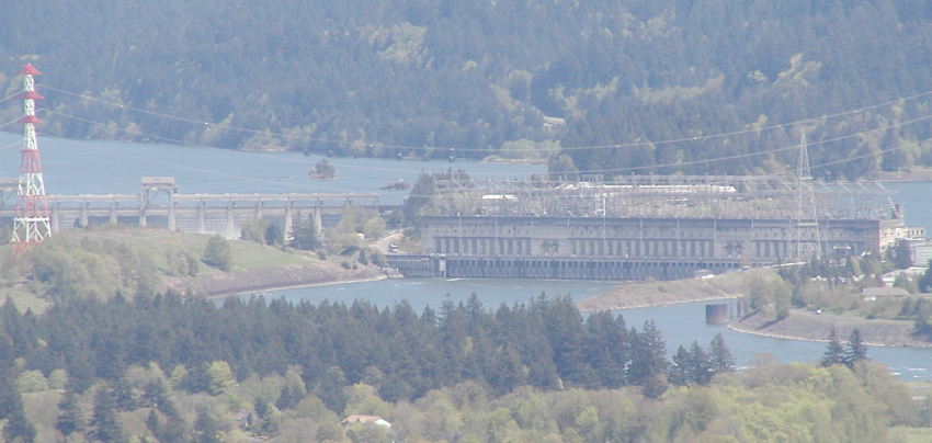

Ah yes, I have a water-based power plant actually, it's right next to my battery-powered battery charger.
