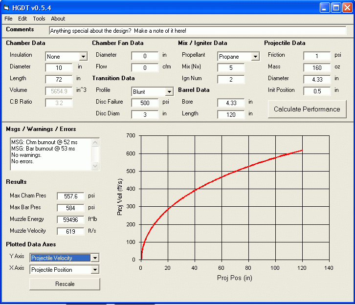

If you haven't already, go get HGDT. You can model your gun to your heart's content.
If you must keep the chamber. Don't go over a 2x mix. Go for a 4" dia., 10' long steel barrel. Not sure what the heck you're going to do for a burst disk holder and burst disk material. Find a 4" burst disk that will burst at somewhere between 100-200 psi....good luck on that.
Here's what you can expect:
Over 20,000 ft*lbs of energy and 575 ft/sec velocity...yeah that ought to take a small tree down if hit right.
Don't worry, it will be loud.

I see everyone is putting their recommendations up, so here is mine.
_____________
Chamber stuff:
As D_hall suggested, I would also recommend at least 1" thick end plates. Maybe you should ask your buddy if he has any way to get rounded plates though?
I wouldn't limit myself to 2x, but I wouldn't be standing next to it either.
And I wouldn't be too concerned with DDT. You should be using more than one spark gap anyway.
I did a calc on hgdt, and the difference between a 72" chamber and a 48" one was only like 3500 ft-lbs @ 5x. Your call though.
I can't really recommend over 3" porting for a 4" barrel. You'll see a 5-10% performance loss, but a 4" disk would probably be more trouble than its worth.
_____________
Barrel stuff:
Steel thinwall conduit is probably the way to go. 10' of 4" will probably weigh around 70 pounds, but it's infinitely cheaper than aluminum.
Plus 4" is actually 4.33" ID, which gives a noticeable power boost.
If you buy it new, expect to pay up to $100.
Mcmaster has 3 & 4" conduit for 60 and $80 respectively, but shipping would kill you.
#7126K9
Reasonably optimal figures. <br /><br />I should also point out that you could get around 100,000 ftlbs with a 20' barrel. I wouldn't cut the chamber down any if you plan on this.
