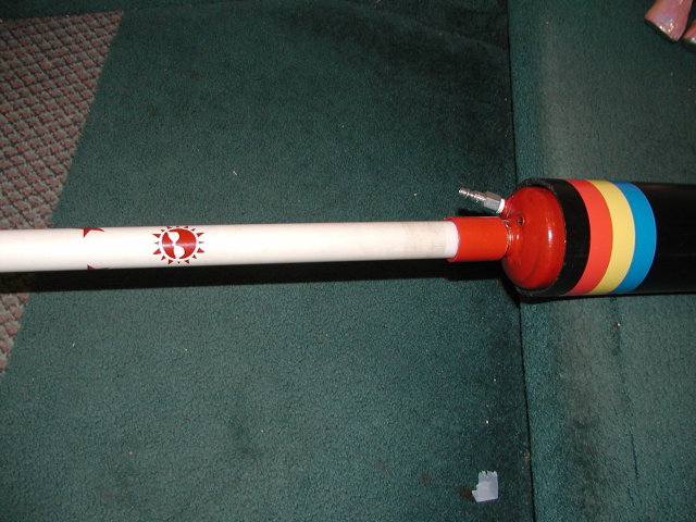

I"m so glad you started this thread cause I am really excited about my new gun and I wanted to show it off but its not done yet. here it is. as you can see it dont have a sprinkler valve. I cant find one anywhere so I'm gonna have to order one online. its like no one in kentucky waters their yard. lol. also I gotta make a barrel support for it. and eventually I"m gonna make a bi-pod for it. <a href="http://s584.photobucket.com/albums/ss29 ... ix0180.jpg" target="_blank"><img src="http://i584.photobucket.com/albums/ss29 ... ix0180.jpg" border="0" alt="Photobucket"></a>
<a href="http://s584.photobucket.com/albums/ss29 ... ic20-1.jpg" target="_blank"><img src="http://i584.photobucket.com/albums/ss29 ... ic20-1.jpg" border="0" alt="Photobucket"></a>
- inonickname
- First Sergeant 4
- Posts: 2606
Try an irrigation supply place.
Nice gun boom, should be a clean and powerful thing to play with.
