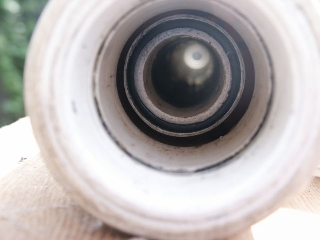

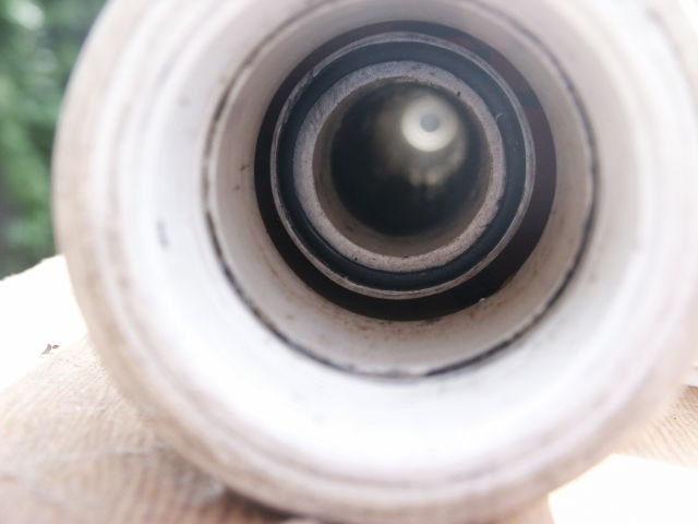

velocity3x wrote:Technician,
When I first switched to the ball valve design, I used a 3/8 valve. 4 out of 5 times, the piston wouldn't open fully. I moved up to a 1/2" ball valve and found a power increase and more firing reliability (about %80 reliable). Settling on the 3/4 ball valve, the piston ALWAYS %100 fully retracts and the cannon power became huge. I'm not saying QEV's are bad...they just don't work on this cannon.
From what you are describing as symptoms indicate the valve seat is relatively small in relation to the OD of your piston. For example a 4 inch piston sealing a 2 inch barrel. What happens with these is due to the area of the front of the piston blocked by the barrel (small area) does not provide a large force increase as the piston opens as it is only 1/4 the area of the entire face of the piston. (boost 25%).
Because of this and the remaining 75% of the piston face is exposed to chamber pressure, the pilot area when vented down only 25% lets the piston begin to open. Two very important things happen.
One, the chamber pressure starts to drop rapidly
Two, The pilot at 75% of chamber pressure quickly feels the squeeze of the piston coming back. If it moves into the pilot area 1/2 way, the pilot pressure (assuming no continued venting for clarity) the pilot is now doubled in pressure or 1 and a half times the original chamber pressure, which is now rapidly diminishing.
The result is a valve that burps instead of popping fully open. If you can, re-make the valve seat area at least 3/4 the diameter of the piston diameter, or continue to use a really big pilot to keep ahead of the aforementioned problem.
When I build piston valves, I always make sure barrel sealer valves have a large seat in relation to the OD of the piston so the valve remains fully closed until the pilot area pressure is at least under 25% of the chamber pressure.
Watch how it is different.
Pilot at 25 % of chamber pressure will increase to only 50% of initial chamber pressure when the piston moves back and takes 50% of the pilot area. Hmmm. It's still being forced open, not closing..
The face of the piston with 75% of the face covered by the barrel sees a force spike that is 3X more than was originaly holding it closed.
These POP open, a true QEV as a main valve.
Oh by the way, what is the diameter of the sealing area of the piston and what is the OD? Is this ratio any where near 2:1 for an area ratio of 4:1?
EDIT, I just looked at your cannon on page 1.. Not a ratio problem, but may be a flow problem from the tank to the valve. As the valve opens the distance, plumbing and such may create a very rapid pressure drop at the valve on the chamber side of things. High piston blow-by will also cause it by keeping the pilot area pressure high. This will need a large pilot to vent. Is there any way to use larger plumbing from the SCUBA tank to the valve and maybe reduce the piston blow-by to the pilot area?
Restrictions between the chamber and piston will cause that type of problem. It is why I prefer coaxial designs.
Mouse Musket valve seat.  Piston OD 1.5 inch. Seat 1.25 inch. Barrel 1 inch.
