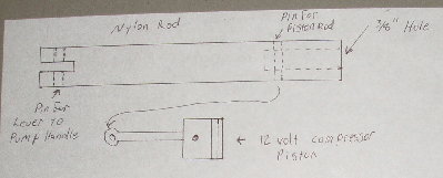

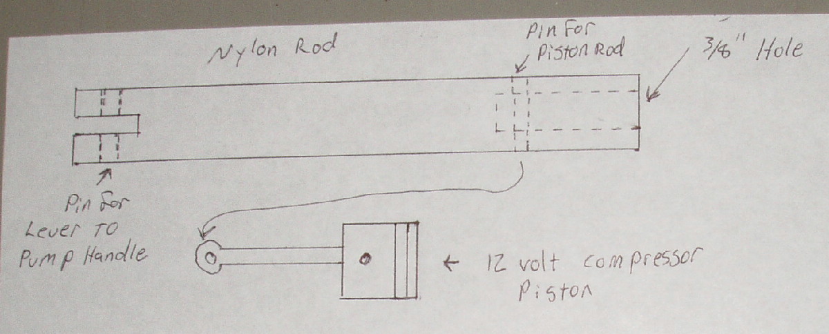

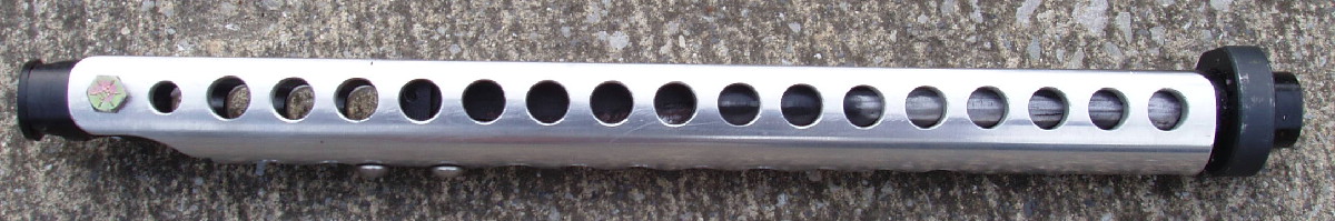

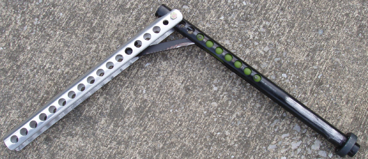

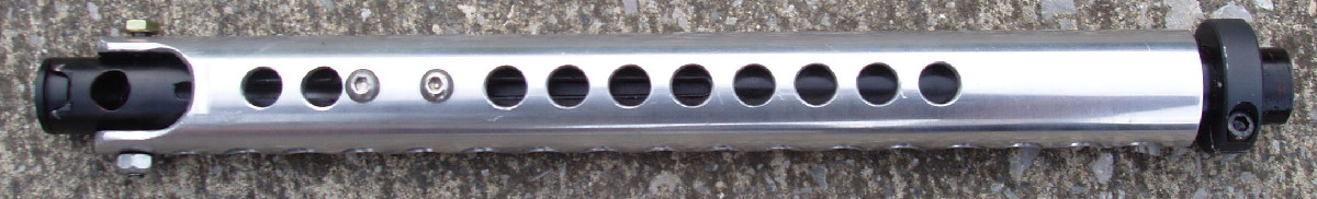

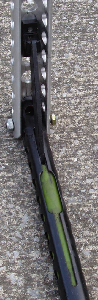

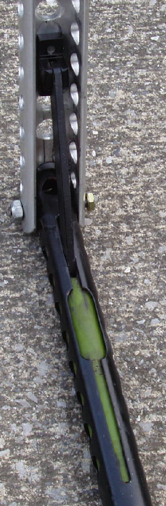

here are pics of the pump.

Bear in mind, innovation is not just about new ideas, but new ways of doing things. I'm sure a built in pump like this (very rare to see done efficiently on a spudgun) would have been perfectly acceptable as far as counting for innovation.

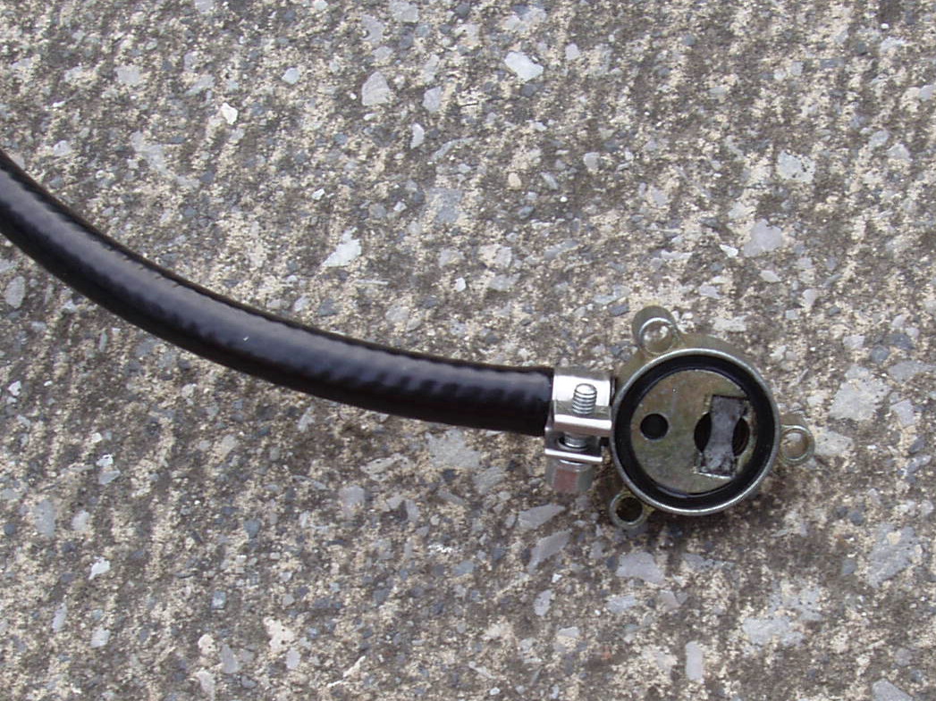

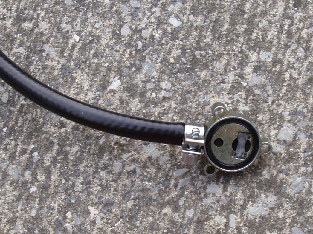

I love how you used the head off a small compressor for your check valve/fill tube assembly. I have a couple of junk compressors with heads like that, and it would make a great solution for the pump I'm putting on my next project.
of course, I'm planning on a traditional stirrup-type pump rod, not like the pump assembly you've got going on.
Just the same, It's an awesome idea, and I can't believe I didn't think of it already.

What is the range of motion of the piston inside the pump in terms of inches during one cycle?

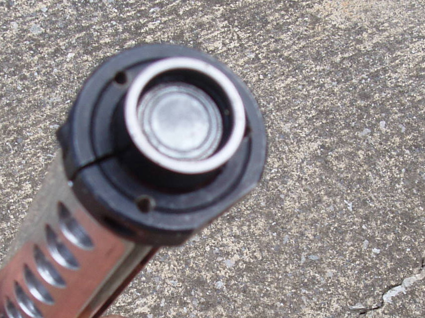

Is there any way you could show us the piston outside of the cylinder?
How many cycles does it take to attain say, 300 psi? Probably not too many considering the small chamber volume.
Thanks again.
Thanks again.

I don't intend to be harsh, but reading a little more closely might be to your advantage. Two of those questions were answered in the opening post...
Question:
Question:
Answer:King_TaTer wrote:What is the range of motion of the piston inside the pump in terms of inches during one cycle?
Question:wngovr wrote:... now the 3/4" piston has a 6" throw.
Answer:King_TaTer wrote:How many cycles does it take to attain say, 300 psi? Probably not too many considering the small chamber volume.
wngovr wrote:... so pumping up to 300 lbs. is a breeze. About 35 to 40 pumps.

Hey, thanks for all the positive posts guys, Im glad you like it.
King_tater,
I don't want to take the piston assembly out because i put super glue on the pins to keep them from working their way out and scoring the cylinder walls. I drew this picture to try and show you whats inside. The piston had a piston arm attached to it so I drilled a hole in the end of a nylon rod big enough to allow the piston rod, then drilled another hole to put a pin through the piston rod. There is a little space between the piston and nylon rod to allow the piston to move freely just a little separate from the nylon rod.
Yes I considered making a piston valve, but I've never made one before so I would probably have to make two or three before I found a system I liked. Just so happened that I found this q.e.v. in a junk box at work. It didn't take long to see how the gun could be built around it I guess you could say I took the easy way out.

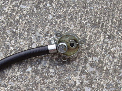

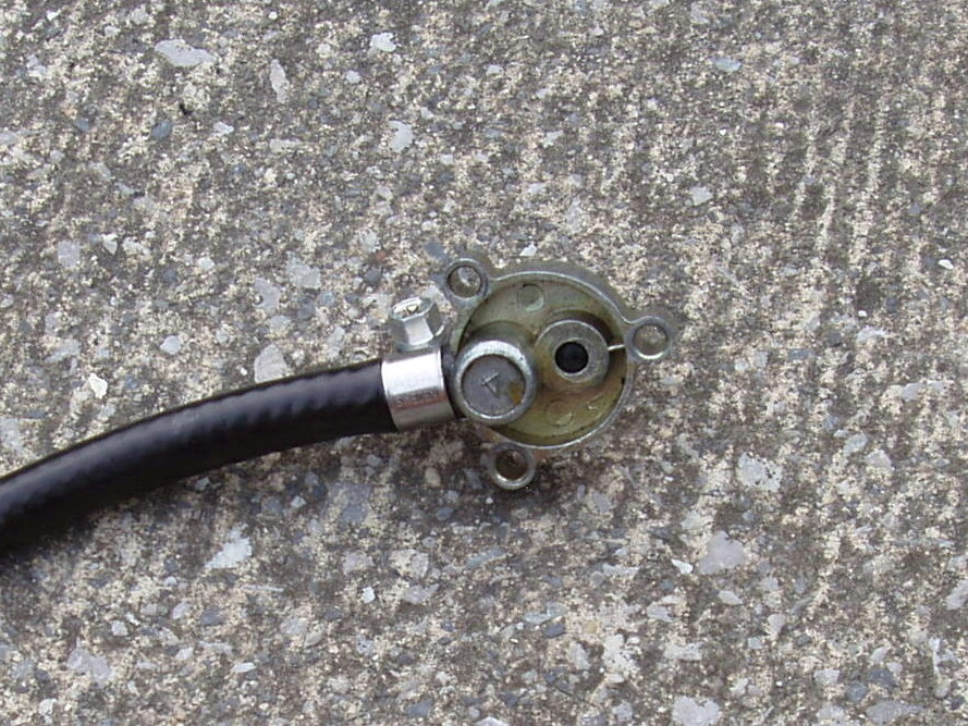

The q.e.v. and the pump leaked when they got over 300 lbs., so I bought some slightly over size square o rings. I put them on yesterday and pumped it up to 400 lbs. took 75 stokes. then I remembered the tube is only rated at 300 psi, so I ordered some grease gun hose. My pressure gauge goes up to 500 lbs. If I keep pumping something is going to blow. I imagine the piston seal or the pump head valves will go first. What do you guys think?

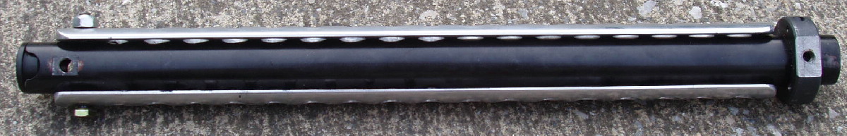

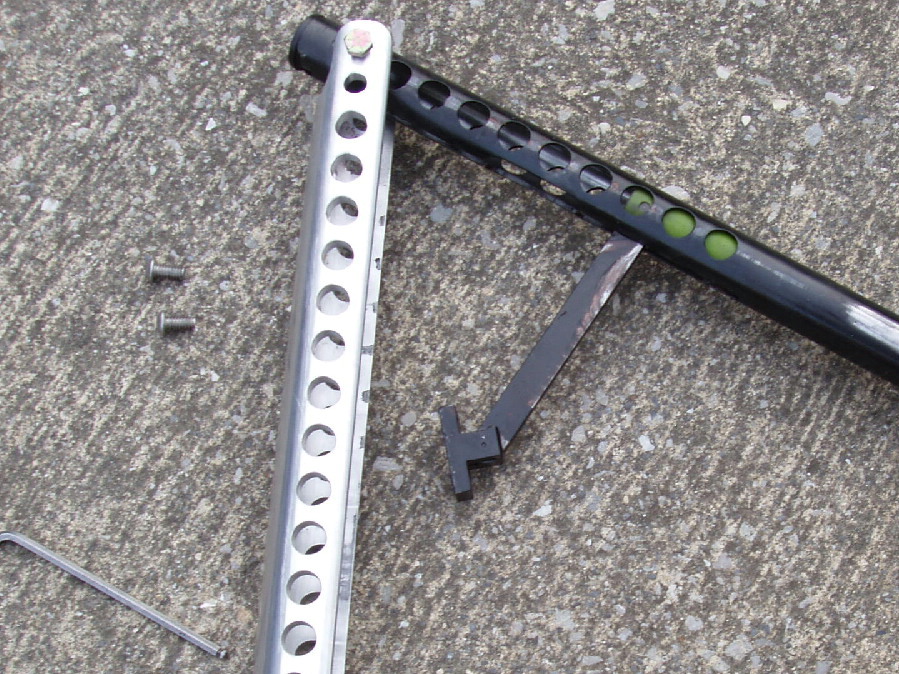

Just remembered, I ordered a 5 inch black foam blowgun handle to put on the end of the barrel. Just for looks. If I drill a bunch of holes at the end of the barrel under this foam, will it work as a bit of a silencer?
Small metal sprinkler type valve, or q.e.v. or solenoid valve:
http://www.mcmaster.com/#solenoid-valves/=2zrm7p
part no. 4738k138
