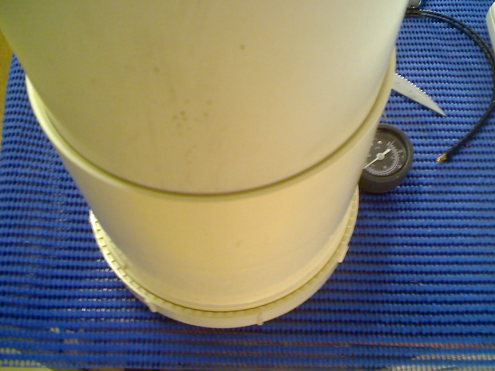

that link you posted doesnt seem to say that the medium bodied glue is designed to fill in the gaps ,the american one does
upto 6" diameter 6" aint that big here is a pic of a 6" socket in a piece of 6" pipe. there aint much of a gap, infact there is next to no gap, no need for medium bodied glue ,altho american fittings may have a larger gap ,hence the need for medium bodied (gapp filling) glue, they simply dont sell gap filling glue in australia, maybe our fittings are desinged better?

on my 4inch fittings there is no gap either, infact i takes quite abit of force to get them together for a dryfit with no glue, its even a harder job to get them back out......
