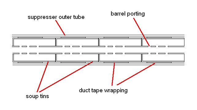

With a little bit of duct tape wrapping, a soup tin should fit pretty nicely in 3" pipe. If you can punch a hole in the bottom the size of your barrel's outer diameter you can use a number of them as baffles inside the silencer in the same way that some firearm silencers are made:

so with a 3' tube i should have the first half lightly packed, tightly, or medium, then soup cans the rest of the way. . . i just want to make sure, this thinks a pain in the ass to take apart
If you're going with soup cans it would probably make sense to just have them all the way, without any packing.

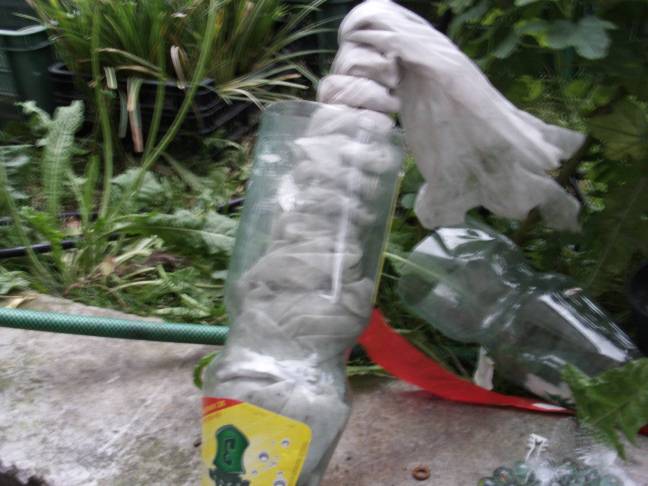

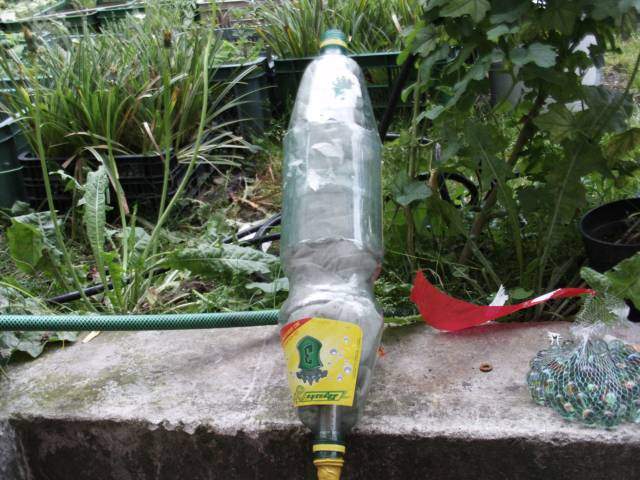

mine consisted of a tube with lots of slits cut in it perpendicular to the barrel, some packed material and the outer casing built from two 2L bottles...
sure it's simple and ghetto but it dampens the sound to acceptable levels while being relatively light...
baffles, on the other hand would probably offer better performance but they add complexity and weight... keep in mind that barrel acts as a lever so try to build something light
