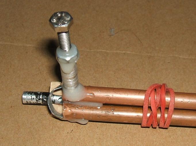

Update: I'm making a 4.5mm prototype to link up with the bottle and valve, based on this design. The BBs are held in barrel diameter tubing, however there is a small hole from where the air feeds (the aluminium tube which feeds into the copper tube not visible in the photo) that leads directly in the chamber before the detent, hopefully this will provide sufficient air for the shot without disrupting feeding. I just need to cover the semi-circular section from the tube mag to the detent and it's ready for a fairly complex casting.

edit: here's the unit curing, magazine and barrel are all held in an epoxy filled 3/4" thick walled pipe so it should take 850 psi comfortably, but for now I'll just test it at compressor pressures later in the day.

psycix wrote:My guess: it spits out all the balls at once, but I hope I'm wrong.
Whilst I hate to admit it, it's beginning to look like you're right :roll:

I gave it a few whirls at 110 psi, no go - feeding is erratic at best, if at all. I'm guessing I was a bit optimistic with the bends between the mag tubes and barrel, it seems the BBs are jamming there. I'll try it at 850 psi tomorrow but I'm guessing it's not going to work.

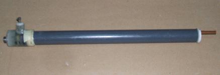

I put a detent, the idea is that it catches each BB as they pass and slows down the rate of fire, not quite dakka dakka but fairly reasonable, like what I achieved with this.
If you want the daka-daka thing ...you're back to QEV-pop-off or rattlesnake...
The whole idea of dakka-dakka was to maximise individual shot power to compensate for the fact that I was stuck with compressor pressures - but now that I have HPA on tap, I want to milk it for all its worth :D
