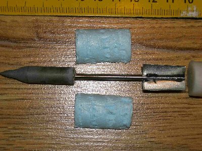

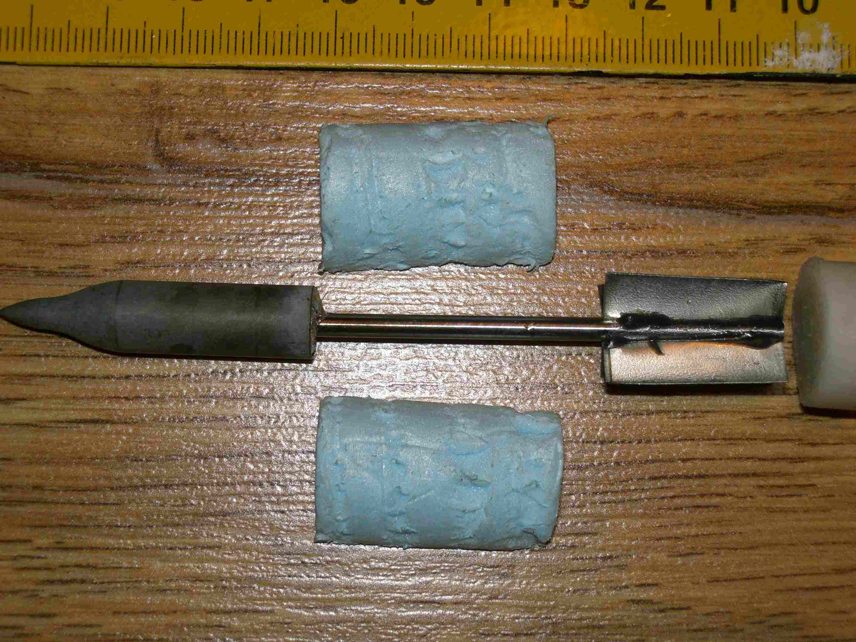

The problem with a large wax sabot is gonna be added weight, if you are gonna use these in a larger than .5" barrel use a foam sabot(split lengthwise" and a short piece of wooden dowel or a shotgun shell as a wad... In .40" or 3/8" barrels an empty 9mm case makes a great wad and in a smallish bore the wad driving the nail forward combined with the drag of the collar actually will keep the point centered... When you are dealing with several thousand G's the head of the nail will remain flat against the wad as long as the nail isn't tilted past it's central COG...
Nail-Dart-Sabot

For beeswax, density ranges from 0.958 to 0.970 grams per cubic centimeter (g/cc). Paraffin is about 0.93 g/cc. Carnuba wax runs about 0.97 g/cc.jeepkahn wrote:THey may be restricted in the UK and other firearm unfriendly countries, due to the fact they use .22cal or .25cal "blanks" to drive them, some countries consider powder fastener tools as firearms...
(Or almost water density.)
1" cylinder of wax weighs 8 gm
Remove a core for the nail and to create a point and assume 5 gm.
Is this a lot?
How much weight would the lead sinker add?

I haven't gotten a scale yet, but the balance point is 1.251"+/-.002" from the head with the collar pushed all the way back to the head...

I've not tried 2 collars, but I'm guessing your are forgeting that with a high velocity fin stabilized projectile any pitch or yaw will expose more fin surface area creating a much lower cross sectional density that will draw the tail back in line... and rough measuring and calculating says that the fins alone offer .020"^2 of surface area when flying straight, but at a 90degree angle to the flow the fins account for about .136"^2 of surface area greatly reducing the cross senctional density relative to flow...
