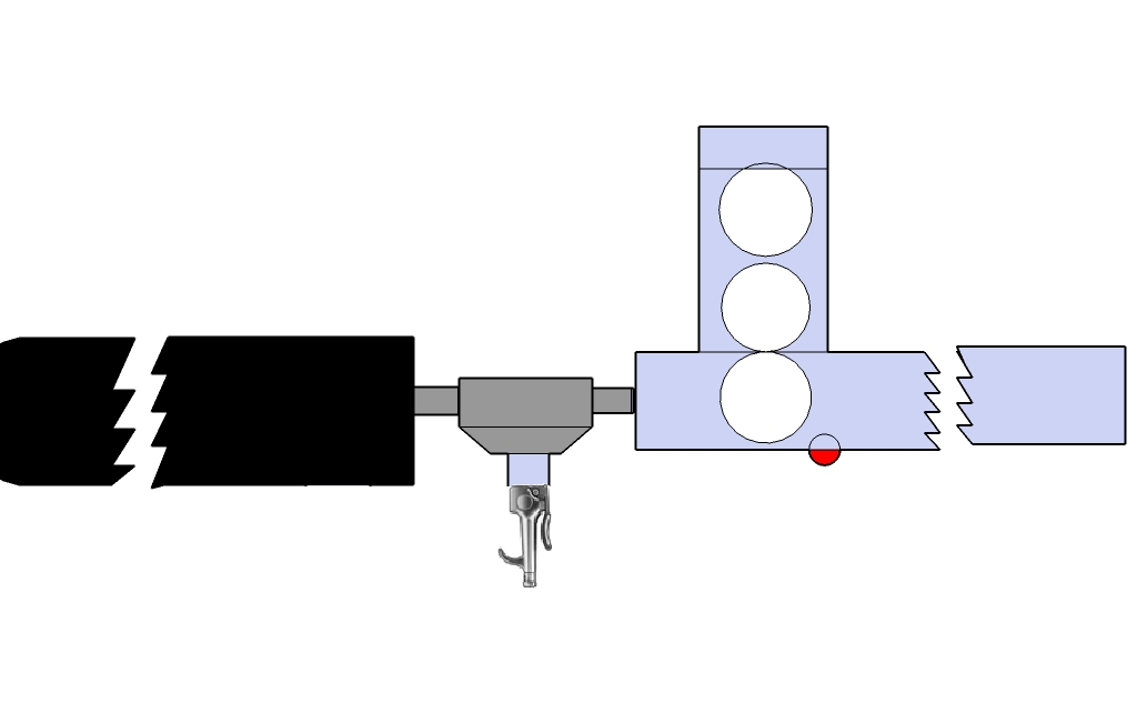

I'm sorry to double post, but I have an Update on my progress. I have recently come into possession of a large fire extinguisher that is about a foot and a half long (or about half a meter). Since most of my semi-auto plans were shot down, i decided to go with a regulator setup. co2 is too expensive atm, but I think this will work great. I am going to put This regulator on This full-metal chamber (see below) it will be pumped up to 200psi and incorporated into some sort of stock, or backpack(its just a little to big to put on a belt).

I'm not sure I understand what's going on there. Why do you have 2 connections to the chamber?

whoops i'm sorry that second connection is just supposed to support the valve so that it does not bend or break, i probably should have specified that
in the notes, but any way, the second connection does not hold air
my mistake sorry

Well I don't see the need for a slide valve in this setup. I would use a blowgun or a ball valve.
Since it's no longer semi auto (right?) I'd say forget the magazine/hopper. The design you have for that would not work anyway because there is nothing to seal the breech opening. Unless you capped off the magazine, backpressure would simply push the stack of balls out of the hopper and the ball you intended to fire would hardly go anywhere. Even with a capped off magazine, you'd have to ensure that no backpressure can leak around the ball about to be fired. You'd lose some performance there.
Either stick to good old muzzle loading or reconsider a breechloading design. I'd suggest cutting out a section of the barrel to drop in rounds one at a time, and to fire, cover the open section with a sleeve.
Better yet, just buy this.
