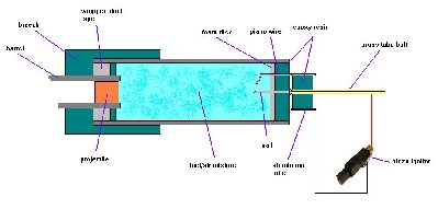

Power was a bit dismal though, a 9 x 0.177" steel BB buckshot round punched through a relatively flimsy acrylic box, but not the cartdboard backing:
Same results for a marble wrapped in tape:

Maybe you need a longer section for the cartridge to slide into, before it vents to the atmosphere, as it kicks back? Calculate the length given the relative inertia of it verse the projectile, and all that. If the cartridge gets kicked out too soon, then the projectile may only be accelerating for a small fraction of the barrel length. You can test how much efficiency you are losing by the cartridge ejecting, by clamping it in and firing it like that.
I tried with a much stronger spring that barely let the cartridge move and it didn't seem to make a difference.

The cartridge/bolt contact points are pretty hardwearing and should be able to take a lot of punishment, here's what the internals look like:
Nice design for the electrodes. Possitive contact no matter what.

jackssmirkingrevenge wrote:Power was a bit dismal though
One possible solution to that might be using a fuel-oxygen mixture rather than a fuel-air mixture. That could potentially up power by about five times, assuming the cartridges could take the pressures involved.
The most sustainable way (in that you wouldn't need to buy oxygen cylinders on a regular basis) to do something like that would probably be an electrolysis cell.
In my personal opinion, there just isn't the pressure behind an atmospheric fuel-air combustion to really be able to run a cartridge set-up that has any real power.
You probably need to up the ante somehow - whether it's by fuel-oxygen mixtures or hybrid cartridges is up to you.
I flirted with the idea here but never actually made anything because of a pathological fear of handling pressurised oxygen, but what I never though of was
