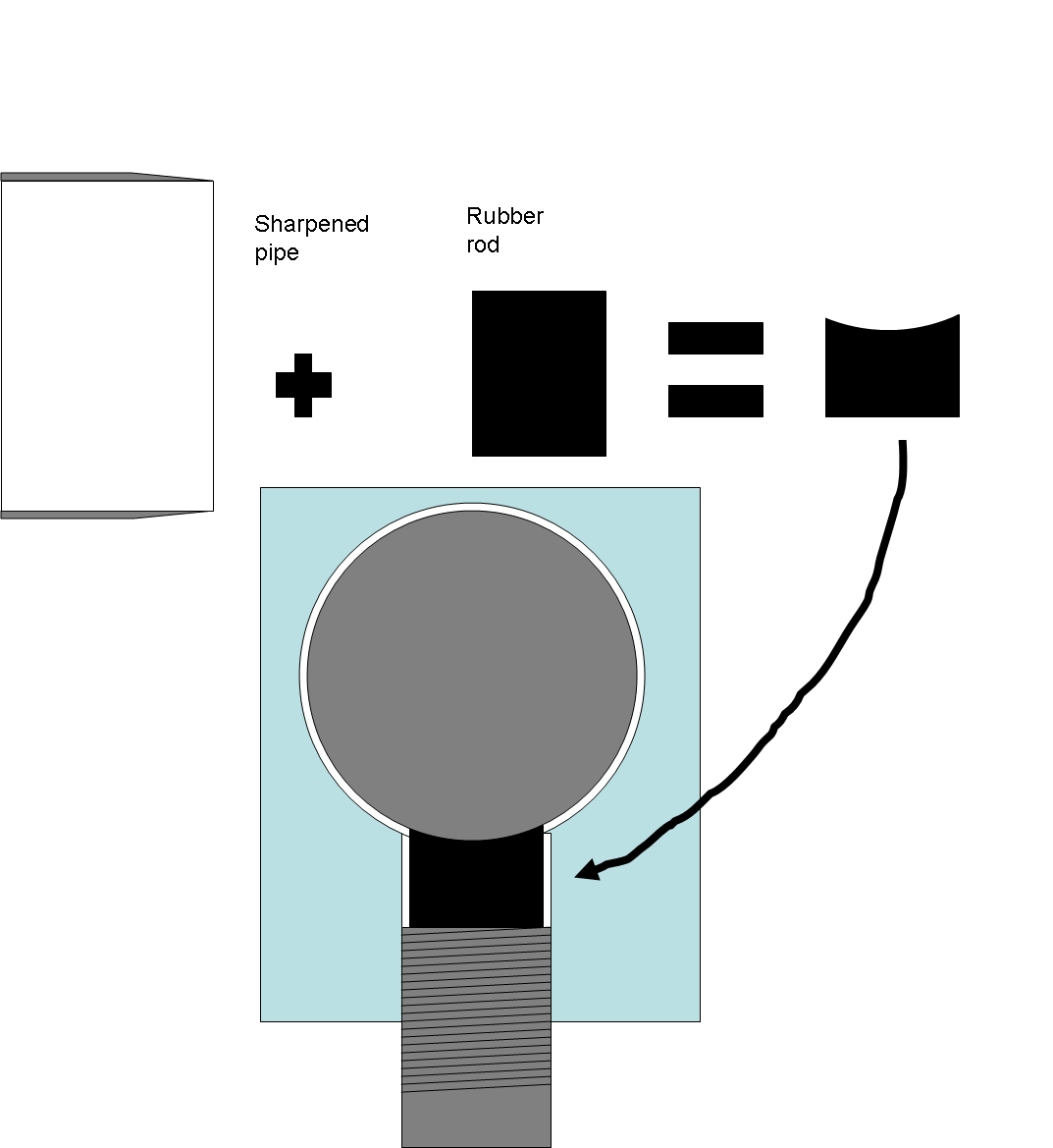

hmm I'm thinking you could cut a curved end in a rubber rod using a sharpened pipe, for a rotary valve

anyway's so in the aaaa.png picture I pointed out how the profile of the oring does not match the profile of the rotating rod. So to get a piece of rubber that does match the profile of the rod, use a sharpened pipe about the size of the rod to cut a rubber rod like so, and you could also use the threads of the attached fitting to tighten the seal using that method you should be able to construct rotary valves

well there wasn't much rod to put o-ring groves on, and I just saw disks between nuts, well just to let you know it is a way you can make seals and it's adjustable
and yes your opinion about rotary valves has already been noted, but regardless of your opinion it's nice to know how to construct them because it has frequently reappeared in threads

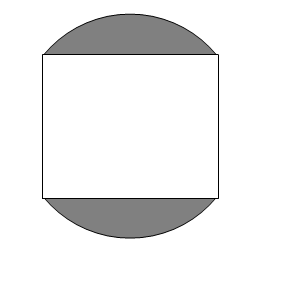

modifying ball valves for a rotary valve purpose is too difficult, the diameter of the hole is too big in relation to the diameter of the ball, the below picture should give you an idea of how difficult it is to mod a the ball
