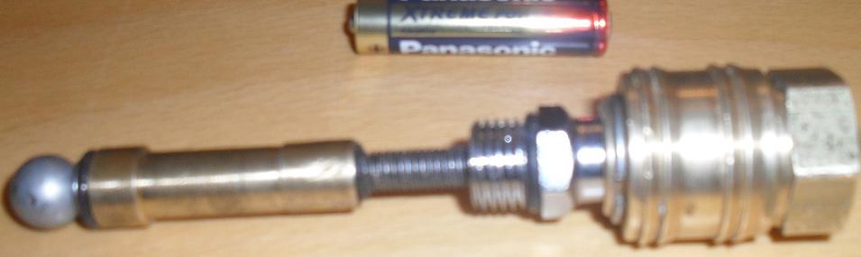

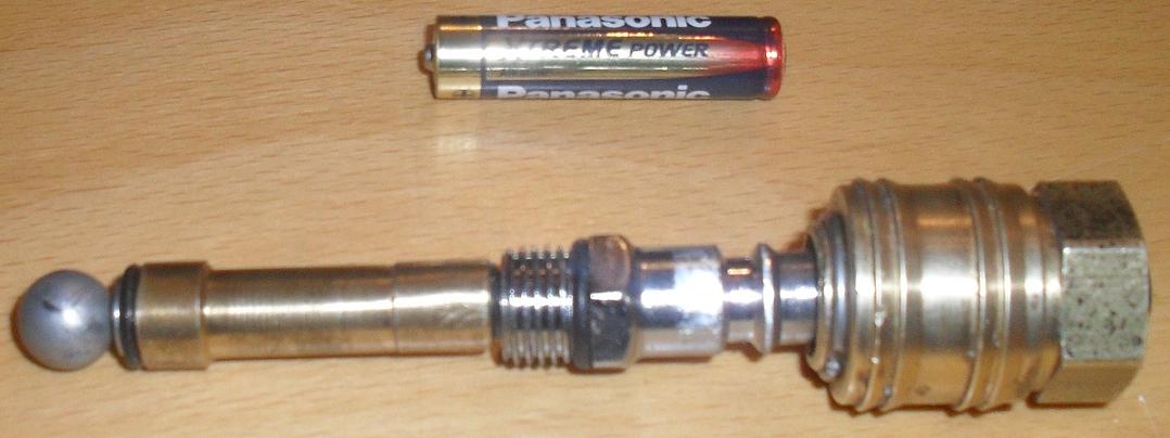

Now hopefully the breechlock will come to me..
All I need is a longer m6 bolt so I get a longer stroke and room to put in a spring...
Luckily I choose a caliber that is just right for tapping in 1/4" threads.. :D
With the longer bolt and spring I can just slap it on and voila, bolt and breechlock...
Simple as that!
Unlocked and open...
Forward and locked...<br /><br />These fittings have a 40 bar rating so I'm good...

and an EXCELLENT idea using a quick connect to lock the breech. will that assembly with the piston end up on the threaded side of the QC?
Netherlands
Posts: 3497
I'm not sure what you mean..it is assembled..i the same order it will go into the gun :roll:
The threads you see screw into the back of the barrel tube ( behind the T) and a hole will let the ammo in.
Retracting the bolt will make the ammo pop in, closing the bolt will push the ammo into the Tee..
A magnet on the tip will prevent it from rolling out
I don't get it at all.. is a flow-through bolt or a solid bolt (one that would slide in a T)? :?
