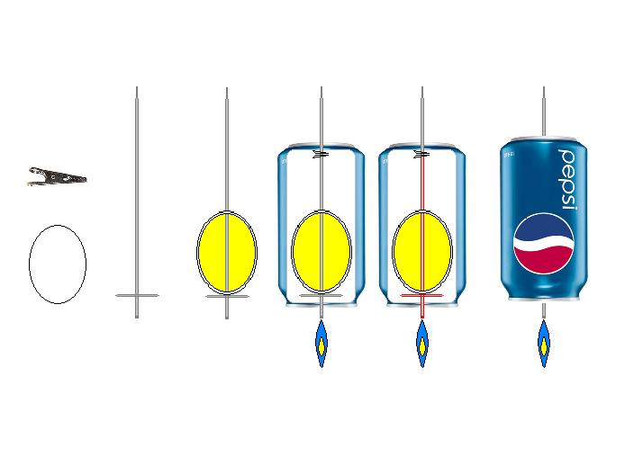

I didn't try my current idea, as D_Hall has tried his, but here's another concept:
Metal skewer, with a small fender washer welded onto it, about 1" from the base of the skewer... A Pepsi can, to redirect the heat, with an a small alligator clip holding the can's position, on the skewer.
EDIT: Forgot to add that the skewer, held directly over the flame, would cook the egg on the inside, while the redirected heat from the Pepsi can would cook it on the outside, at the same time.
