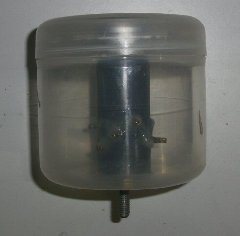

Now that I'm close to getting the turret to work, I'm taking a closer look at making this project reliable. I made a BB sorter as per this concept, see the attached pic (looks a bit like a tiny version of potatoflinger'sairsoft claymore
) - the epoxy is still curing so I don't know if it works yet (or indeed if it works too well and turns into a centrifuge gun, must remember to turn the drill to its lowest setting

edit: the sorter worked reasonably well, though I got it to work much faster by sticking a nylon strap in my drill chuck and agitating the BBs from the inside. End result, all the BBs I tried "filtered" through, ergo oversize BBs are not the problem with reliability - back to the drawing board on the design...

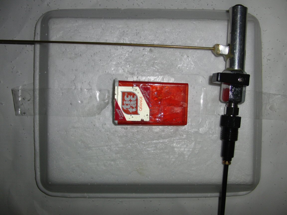

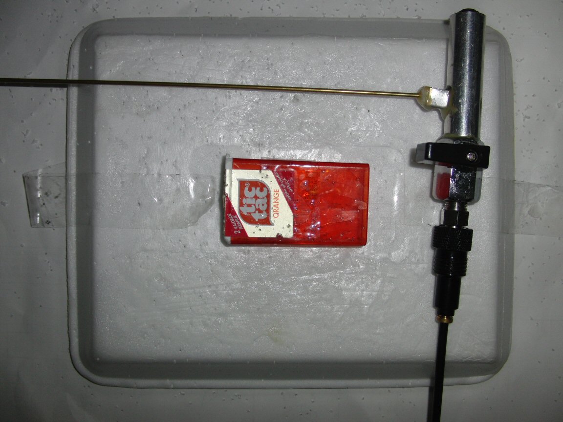

After a brief hiatus from my workbench, got 1mm BBMG version 2 up and running, with a more carefully built vortex block which turned out to be much more reliable. Testing at ranges beyond point blank proved disappointing though, here it is firing at a tic-tac box with a polystyrene meat tray backing from 6 feet away.
You can't really see the impacts, but the camera captured the moment a ricochet shattered the bulb of my floodlight (which as you might remember was left exposed from a 3mm BBMG test
) ah well...
No trouble penetrating the meat tray but there wasn't any one-shot penetration of the box. From a foot away it will happily punch through a cd case, or an alumium beer can. A test against the latter target from six feet away didn't produce a single penetrating hit, just a bunch of dents (and corresponding cloud of stinging ricochets
The idea going so small was that the projectiles would be powerful enough to cause significant damage from 10-15 feet away, but lose power enough for stray shots to be "safe". I hadn't banked on power dropping off this sharply though, and the fact that the spread of shot is greater at distances disperses the impact which makes the effect on target even worse.
Looks like I've hit a dead end, there's no question of increasing pressure, valve opening is aready much greater than the tiny 1mm outlet , and a longer barrel (currently at 13 inches) will make it too unweildy for sentry gun purposes...
