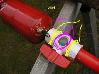

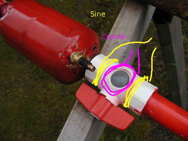

There is a way to directly measure the speed of a ball valve. It can be done by placing a small magnet from a broken walkman earbud in the valve inside a tight ball of wadding. Using a pair of crossed axis coils to detect moving magnetic fields, the movement will generate an electrical sine,cosine voltage pair of the magnet orientation in the two pickup coils. (much like a stepper motor waveform)
Feed this to a stereo sound card input and record with Audacity. No voltage in either coil = no motion. A voltage in either coil = motion. Use Audacity to detect when motion starts and stops.
It is possible to measure the time of a ball valve without a high speed camera.
After I return from the retreat, I can draw up a sketch of how this would be wired onto a ball valve. This will need to be done in a plastic valve.
A similar method was used to time the QDV. Due to the metal tank, the signal was not linear, but start and piston bounce on the bumper was detectable.
This can be used to detect the time on a sprinkler valve.
Edit, found a photo of a valve to draw the coils onto. Plug the sine and cosine signals into a stereo sound card and stuff a magnet in the ball valve with the poles oriented lengthwise the pipe.

Technician1002 wrote:There is a way to directly measure the speed of a ball valve. It can be done by placing a small magnet from a broken walkman earbud in the valve inside a tight ball of wadding. Using a pair of crossed axis coils to detect moving magnetic fields, the movement will generate an electrical sine,cosine voltage pair of the magnet orientation in the two pickup coils. (much like a stepper motor waveform)

On the ball valve coils, each pair of coils should work fine with a total of about 20 turns on each axis to provide a signal to a line in level on a sound card. A strong magnet such as a Neodymium should provide a good motion signal. Due to the low frequency generated a sound card without a strong low cut filter should be used. Use a sound card or capture device that can function well down to 20 hz. Many sound card mic inputs are filtered to remove non voice frequencies such as pops, vibration, fan noise, etc.
