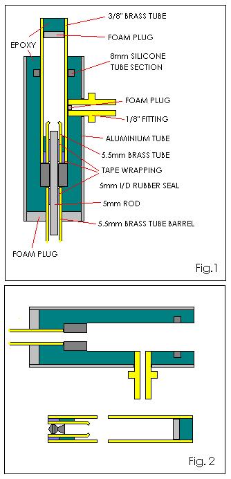

Since there has been some recent interest in epoxy casting, I've added diagrams of the internals while casting (Fig.1) and the final components (Fig.2). Some items of note:
-the cartridge has not yet been ported in order to enable the cartridge body to be used as a inner mould for the breech.
-the mouth of the cartridge uses the same tube as the barrel, crimped at the end to prevent the projectile from being blown into the cartridge
- the 1/8" fitting that will provide the air feed port has been temporarily plugged with foam, which will then be drilled out after the epoxy has cured.
- the barrel, breech seal and cartridge are held with a 5mm mandrel, not 5.5mm, in order to have the seal cure in an unstressed state, meaning it will be less able to expand as the projectile passes through it and will maintain a stronger grip and better seal.

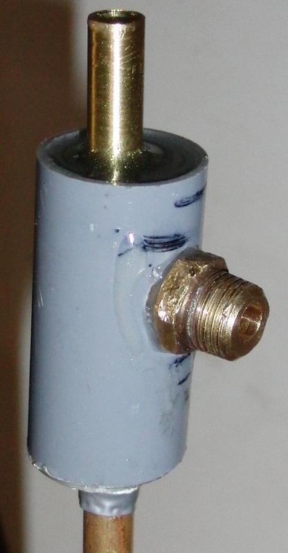

seems I overdid it with the projectile seal, it won't pop at 800 psi - though the cartridge certainly will, enough to take the chamber seal with it :roll:
Back to the drawing board...

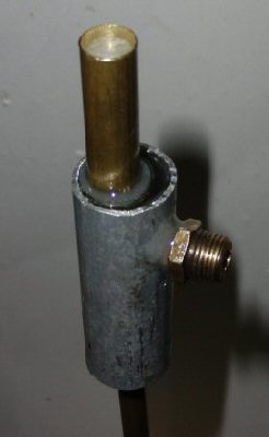

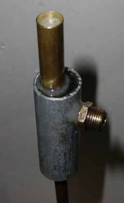

The final setup curing
Internal diagrams
Internal diagrams

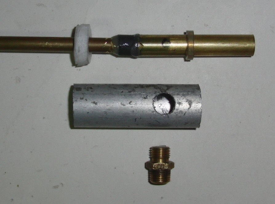

Parts before assembly.  The cartridge has been temporarily glued to the seal for casting, and lovingly swabbed in grease to enable easy extraction after the epoxy has cured.

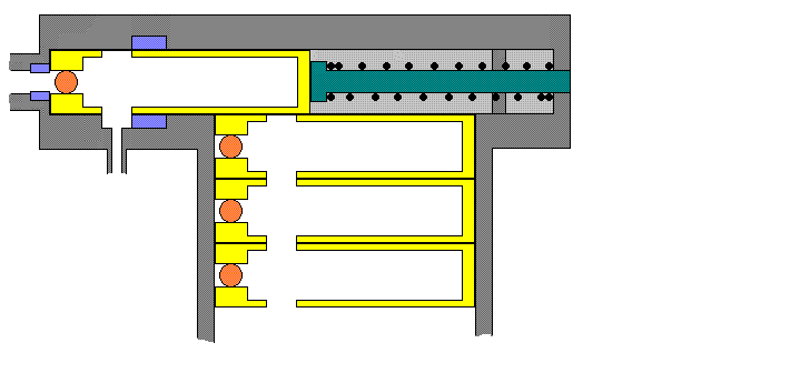

Completed the cycle animation, at least that's how I hope it will work :roll:

This is much better than the air injector needle thingy. The principle of KISS always prevails in then end. How do you expect the cartridges to eject out of the side?
I love lamp
Lockednloaded wrote:How do you expect the cartridges to eject out of the side?
The idea is that the cartridge strikes the off-centre ejector which tips it out of the side, pretty much identical to what I had done with combustion cartridges:
