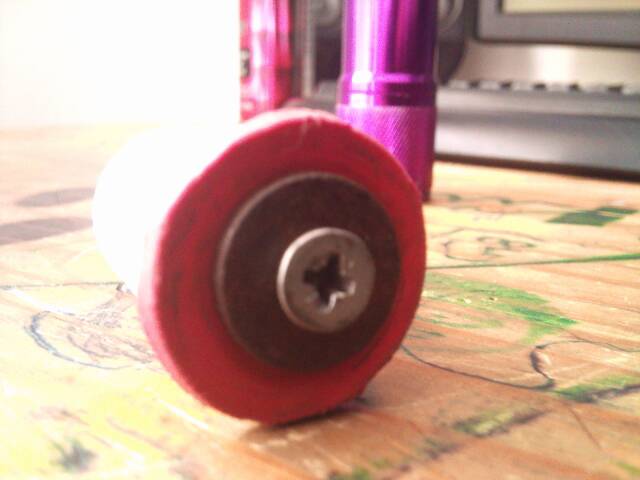

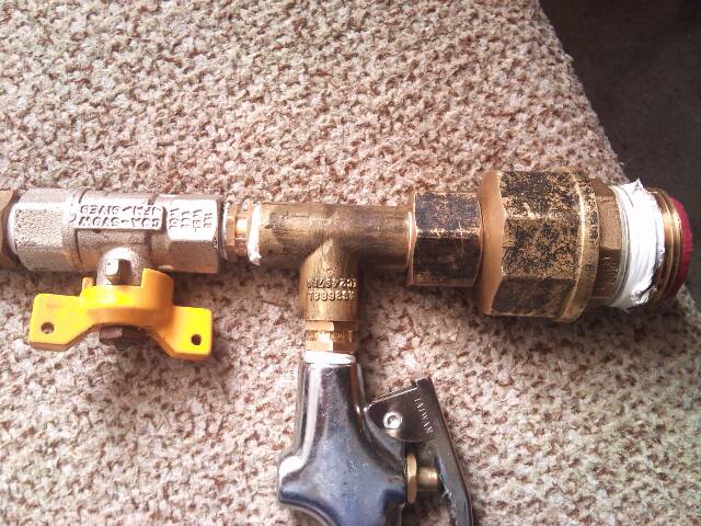

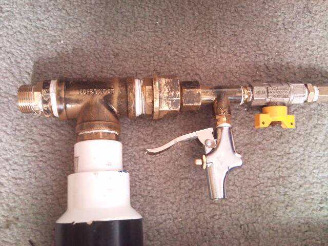

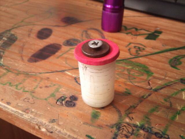

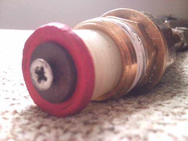

Adding an o ring to the back of the piston can fix the excessive leakage into the pilot.

would i still have to make an equalization hole?
You will need some EQ. I found a 1/16th inch or smaller works very well. Drill in the side and angle past the o ring to the pilot.
I fill from the chamber in the Mouse Musket, Dragon, and Golf ball bazooka.
Sometimes a shot of air in the pilot is needed to close and seat the valve. After that rapid fill into the chamber is possible.

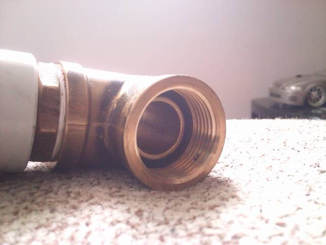

Technician1002 wrote:Adding an o ring to the back of the piston can fix the excessive leakage into the pilot.
Looking at the pictures, it looks more like the seat diameter is very close to the piston.
Can you give us x and y?
It is very close.. I like narrow ratio pistons.. :) They don't need a big pilot to get them to snap open. The bolt is almost the same size as the orifice. :D
Look at the seat diameter in the Mouse Musket. The seat is 1/8th inch from the OD.
The dragon was even a tighter ratio. Piston OD 3 inch. Seat seal diameter 2.8 inches. The pilot had to be bled down to almost nothing before it popped.
When it popped, it was POW. :shock:
Unfortunately the 2.5 inch pipe cap I used for a piston didn't last long.

just modified my blow gun and still wont pilot my piston :(
Try wrapping tape around the piston until it's tight enough that you can barely move it with one finger.

would I still need to make a EQ hole?
unless you have o-rings there's never need for an equalisation hole.
