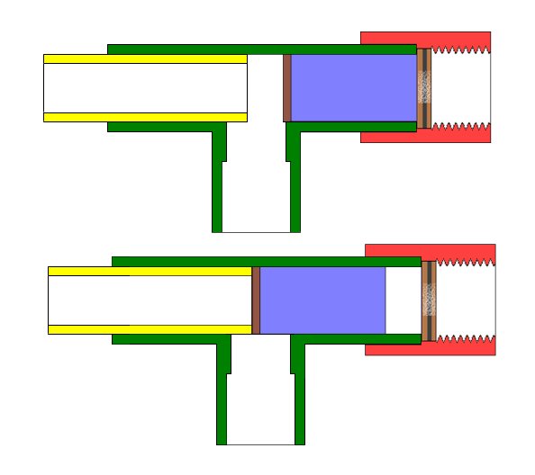

jackssmirkingrevenge wrote:In a nutshell:
I do believe that is it, in a nutshell.
Now, about this one:
This is an accurate description of my 1/2" valve.
Yellow is 1/2" pipe.
Green is 1/2" tee.
Red is 3/4 fitting. (Had to sand the 1/2" tee down some, to fit the 3/4" fitting onto it.)
Blue is the piston.
Seal and bumper are brown
The tee has been hogged out, to allow a 1/2" pipe to go all the way through. The 1/2" pipe is inserted almost halfway. The piston slips in the other side, and is the same OD as the 1/2" pipe.
If you'll remember, I had some difficulty getting this one to work with only a blowgun as pilot. But I did finally get it to work when I made the piston fit to the bore... a pretty tight fit.
But it DOES now work just fine with only a blowgun as pilot.
Again, the ID of the barrel is smaller than the OD of the piston. That is probably why this one works.
half inch piston valve.
half inch.jpg (21.64 KiB) Viewed 3534 times
Very nice. The only changes I would recommend is adding some padding to the thin bumper so the piston retracts the same distance the barrel enters the T from the other side, so when open, the gap between the piston and valve seat is centered in the T. This places the air inlet directly in the widest part of the air inlet and reduces the impact force of the piston on the bumper.
Selador
Posts: 213
Joined: Wed Nov 03, 2010 9:44 pm
Technician1002 wrote:Very nice. The only changes I would recommend is adding some padding to the thin bumper so the piston retracts the same distance the barrel enters the T from the other side, so when open, the gap between the piston and valve seat is centered in the T. This places the air inlet directly in the widest part of the air inlet and reduces the impact force of the piston on the bumper.
I do intend to take that valve apart again later, and try to get better performance. (It works good, but IMO could work better.)
I'll keep your suggestions in mind when I do so.
Thank you.

you need to leave a bit around the piston for the pressure to push against
like this
like this
-_- wrote:you need to leave a bit around the piston for the pressure to push against
Actually there's no need, this is a common misconception.
As the pilot empties, the piston unseals and air gets into the tiny gap between the piston face and the barrel, and that's enough to push it back.
I have found a narrow seat like that promotes damage to the seal. Cutting back the seal is not nessarry. Leaving it full size is not a problem as the pilot pressure reduces and the force on the seal reduces, the outside edge tends to lift on it's own as the force is trying to blow the seal toward the inside of the barrel, thus making the sealing surface near the ID of the barrel.
The forces on the seal may simply blow it into the barrel.
Leave the seal large for a wide suport to prevent a knife edge from cutting it. If you are concerned, you could very lightly cut small grooves on the seat from the outside edge inward about half way to the ID. This would permit chamber air to infiltrate the outer edges of the seal area and prevent a tight seal at the OD of the valve seat.
On my Mouse Musket, I built an o ring into the seat to define the diameter and left material inside and outside the seal for the piston to rest on without mashing the seal. I built the Dragon with the same o ring valve seat.
