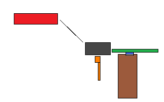

warhead052
Posts: 1769
Let me try and find something on linux that will let me draw what I am going to do. It wont be the best you have seen, but it should show you roughly what I am doing.
Ok, red is fire extinguisher, gray, QEV, orange, blowgun, green, barrel, and then the brown and blue is the hop up and mag.
Rough drawing.png (1.07 KiB) Viewed 2829 times
Crna Legija
Posts: 2333
Location: australia
wyz2285 wrote:A real self-close QEV doesn´t need a hole, I have seen people using real QEV and they fill it from the chamber :wink:
if its a qev you buy not a home made piston valve you need to make a equalization hole in the piston, the piston in them is a one way valve and wont let air from chamber into the pilot with it.
clemsonguy1125
Sergeant 5
Sergeant 5
Posts: 1485
Location: East Coast
They way you have it setup, their is no way it will last for an hour. If you mod the blowgun into a hammer valve you might get a few shot but still not many. If you really want that much firing time, your best best would be regged hpa but that is way out of your budget.
That is all.

warhead052
Posts: 1769
I was being sarcastic about the last an hour thing, but 100 shots is actually perfect. Blow guns are roughly $4 here, and they are rated to about 190 psi.
clemsonguy1125
Sergeant 5
Sergeant 5
Posts: 1485
Ok, I didnt catch that lol, about a 100 shot sounds possible, what pressure can you achieve, I would follow wyz's blowgun mod. While you could possibly get 100 shot, once you get below about 40 psi, the shots are going to be incredibly weak.
That is all.
