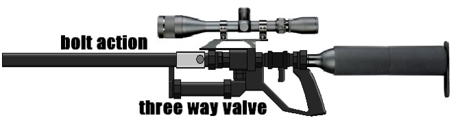

update concept for the semi auto variation of the gun with bolt action and the three way valve
made with ms paint
Looks good, but two criticisms
- a moving barrel will compromise accuracy, why not have a bolt action sleeve instead?
- the main tank size is too close to the firing chamber, it won't be good for more than two or three shots.

if i can find the right tank i will do your idea and not everything is on scale in the concept your picture looks like a talon ss btw
streetfire wrote:if i can find the right tank i will do your idea
A 20 oz CO<sub>2</sub> tank is not too expensive.
streetfire wrote:your picture looks like a talon ss
Actually a Gunpower Stealth but they're basically the same thing, well spotted :)
