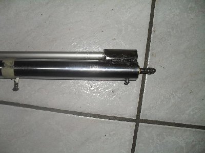

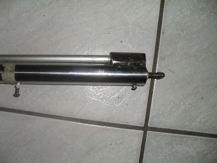

Welded on the barrel mount thingy.I seriously need to fill up those trenches with weld and grind it to a mirror finish...but unfortunately I don't have the time today.
I did get to test it with a 6mm I.D. barrel and it breaks up bb's like nothing...
I do get the feeling that anything over 10 mm I.D. will not do any good.
we'll see....
