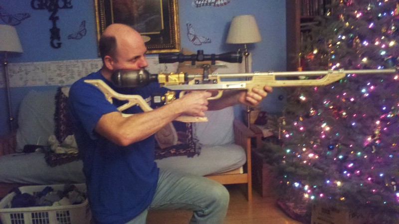

Here is a picture for scale for you. I had to mount the scope a bit higher than I wanted to get the line of sight correct. But, as you can see from this picture (along with my bald head:)), the tank makdes a perfect cheek rest. The gun is very comfortable and easy to hold. Oh, the long aluminum barrel is a little flexible. So, I am ordering a 1/2 inch seamless, stainless barrel for it.
Matt

Looks GREAT!! And that grip looks madly comfortable! Would you let me mold the stock?
Looks great!
