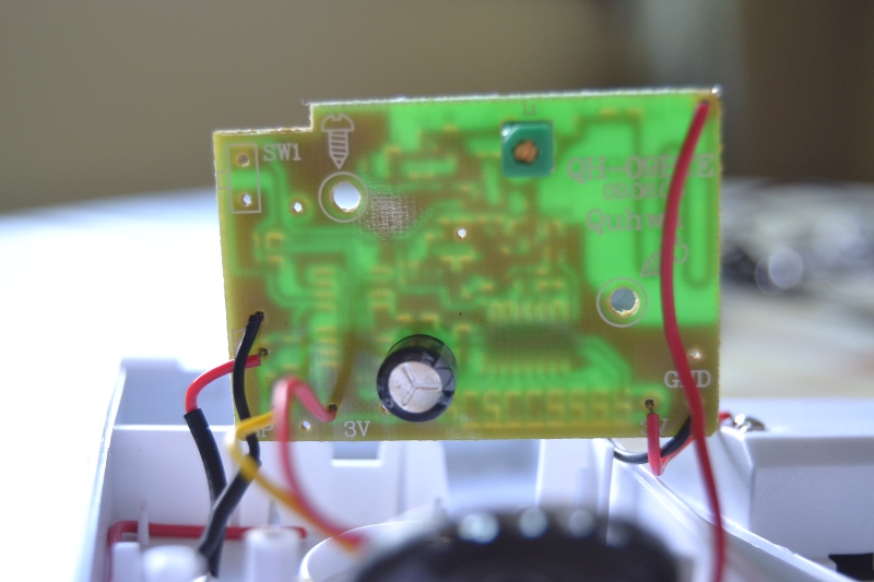

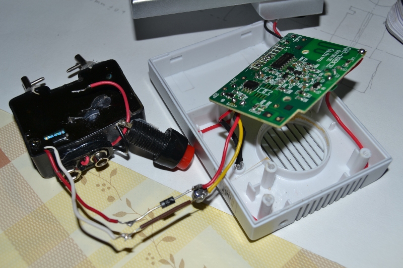

I bought a door bell for this too.

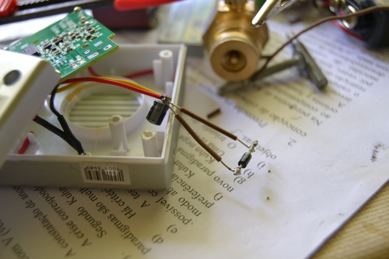

It also use 3v and the bell output says 3v as well, but after adding the cap(I tried 10v 330uf and 10v 42uf, don´t have a 100uf lying around) and the diode, it´s only 0.7v output
also I couldn´t find a 3v relay (even I did it won´t work with 0.7v anyway...) So what could be the problem? Can I use a transistor to amplify the 0.7v to power a 9v tazer?
My bell brand/model: avidsen 102315

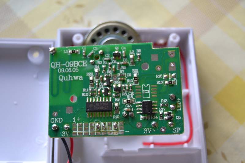

There already is a transistor on board. It is Q5.
There are many ways to to actuate a circuit to control the HV circuit.
Relay is the simplest for those that are not familar with Electronics.

Looks like you are trying to put the diode in parallel with the load, hence you get 0.7 V because that is the diode's voltage drop. You probably want the diode in series with the load. Your max voltage will then be 3-0.7=2.3V.
That might work with a reaay, or you'll need to use a transistor to control the stun guns 9V.

Thanksjimmy101 wrote:Looks like you are trying to put the diode in parallel with the load, hence you get 0.7 V because that is the diode's voltage drop. You probably want the diode in series with the load. Your max voltage will then be 3-0.7=2.3V.
I´m thinking about using a transistor, because I coudn´t find any relay that works with 3v.

It is working now, output it´s around 2.5v
I connected my tazer to it, way too weak to give a spark
So why is it working now and not before?wyz2285 wrote:It is working now, output it´s around 2.5v
- wyz2285
- First Sergeant 2
- Posts: 2388
- Location: Porto, Portugal
- Has thanked: 1 time
- Been thanked: 4 times
The diode, I reconnected it like jimmy101 said
