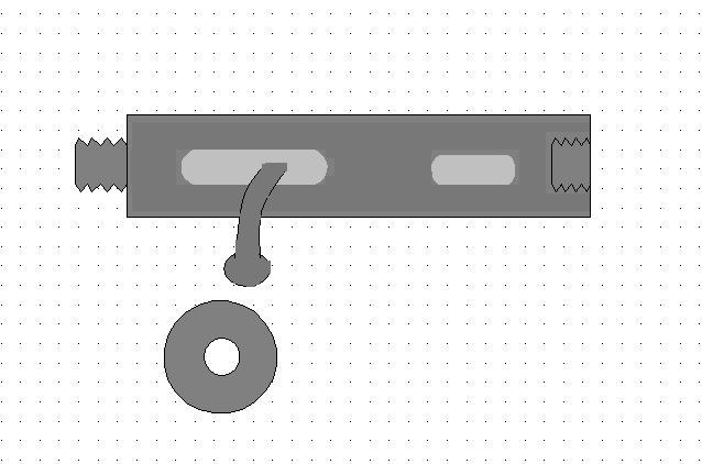

This design, the bolt handle is attached to a tube inside the Aluminium and the light gray part is milled out of the aluminium rod and the slot in front of the bolt is where the ammo goes. (i already have the materials)

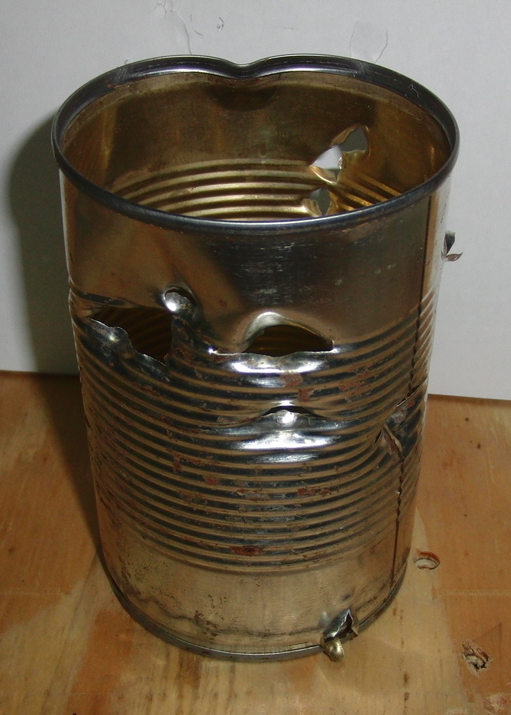

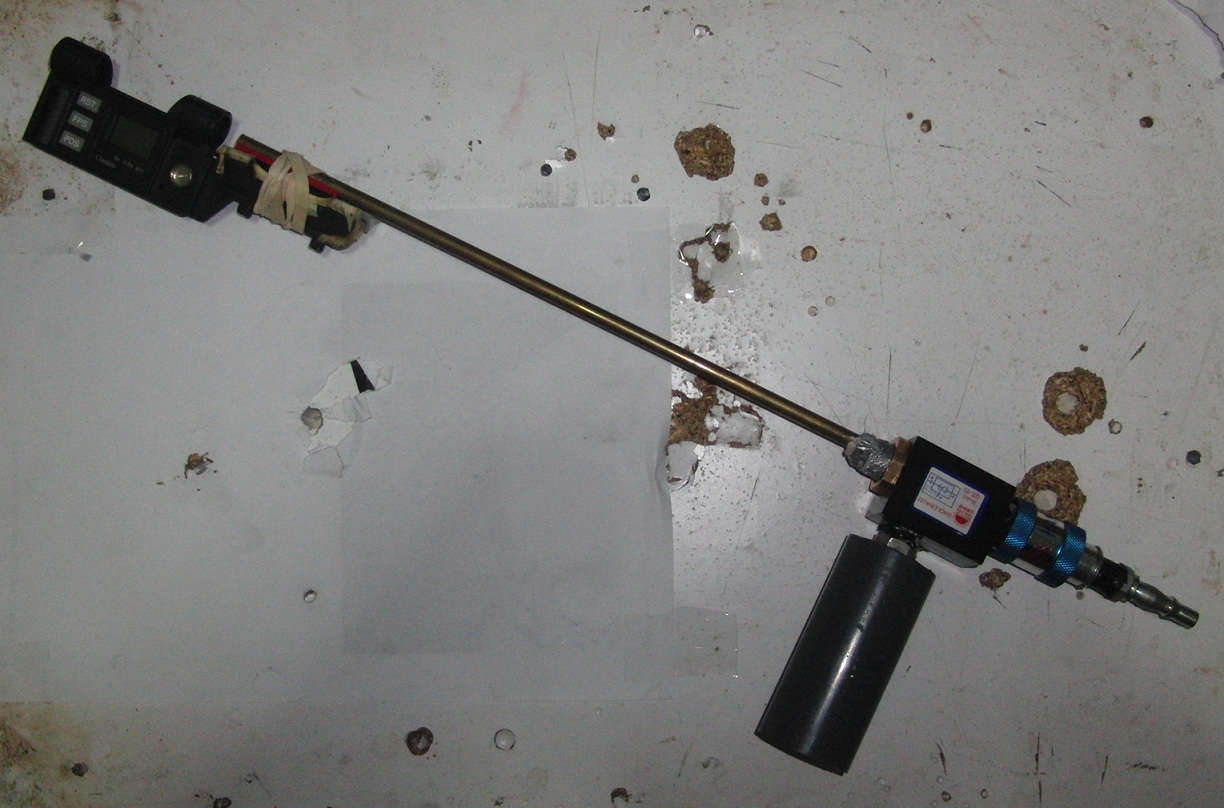

In response to some questions about the sort of power available to this setup, I hooked up a 12 inch 6mm barrel and did some chrony testing at 120 psi. The firing chamber volume is around 3.5 cubic inches, a little wasteful but that's what I had
Using 0.25g airsoft BBs, I got an average velocity of 590 fps, more than enough to punch through a soup tin. With some adapted 1 gram 0.22" pellets I got an average of 355 feet per second, fairly decent.
In short, even at relatively low pressures with a relatively short barrel, this valve setup packs quite a punch. For say a field legal airsoft sniper, if you fit a longer barrel you could get away with much, much less pressure, a regulated main chamber would last a long time.
Conversely, increasing barrel length and/or calibre, and upping the pressure, you have enough power available to do some serious damage. I might do some testing with steel BBs and marbles down the line.
Some photos, my test setup with Combro CB-625 chrony at the end of the barrel, and a mangled soup tin.
