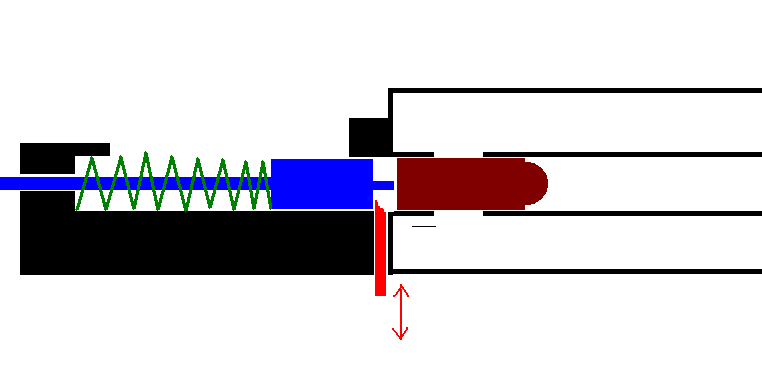

are you going to add a spring behind the bolt and a sear to keep it in cocked position ?
you know... something like this (pic below) ??
springloaded bolt + sear.PNG (8.57 KiB) Viewed 3134 times

The bolt needs to be open untill the actual shot....that would be better...

yes of course!
I waited to see if the PAC is working well
Now I will finish it and put a stick

It would be quite easy to have it open before and airtight during the shot but then it would require some sort of lock to keep it from opening again as it recoils back.
