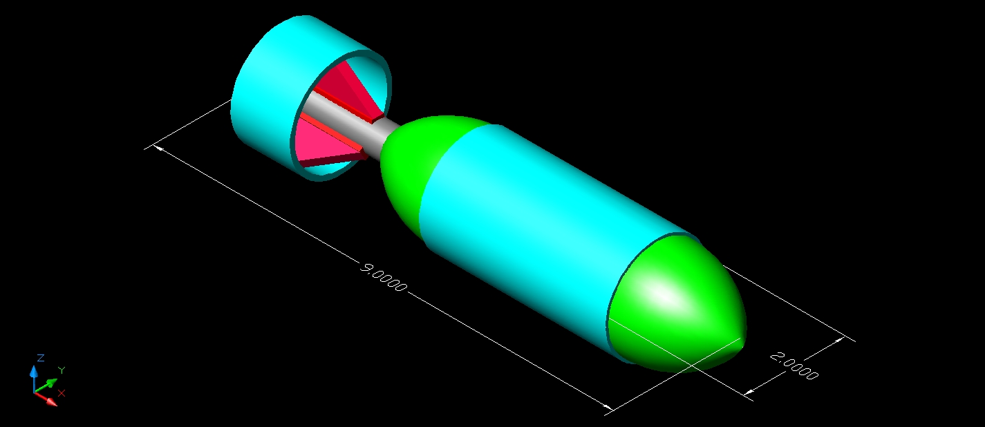

I'm not sure about a discarding sabot's use in a game environment (I could be wrong and they use it all the time for all I know however) but I wouldn't think that using something that's going to leave waste behind would be good. Instead of a sabot, try thinking outside the box for a second...
What if you rolled the t-shirt up tightly, then slipped a rolled up heavy paper poster over the back of it for stability's sake. something like this?
Sure it would require another part, but the likelihood of it hitting longer range "targets" is greater.
There's a chance the paper tale may try to "inflate" as it leaves the barrel though, so there would need to be some sort of way around this whether it's a strip of adhesive or an elastic strap of some sort?
We're here to help you hit the nose bleed section! they need some lovin' too!

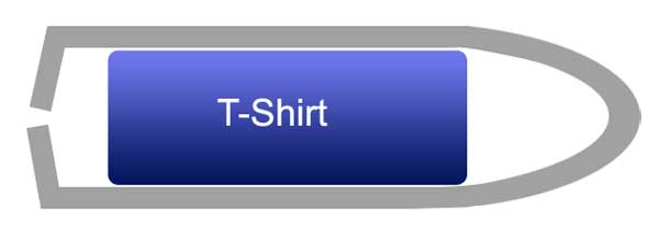

Hi mobile chernobyl. Yeah, a t-shirt bullet! Make a projectile type housing like you have with cardboard. A round cylinder, stick the rolled t-shirt inside, fold the bottom and tape. Make a cone for the nose. I'd have to find an easy way to make them. There's has to be a way, just need to find it.
You could have the team's logo or whatever on the outside of the cardboard projectile. Maybe candy in the back for weight!
- t-shirt-projectile.jpg (6.53 KiB) Viewed 2281 times

A t-shirt becomes a projectile when it is fired and it goes into a crowd. The projectile housing would be a light cardboard or heavy paper. I wouldn't make it out of something that would kill or maim someone.
They wouldn't be pointed. They would be curved on the end. And I was joking about the candy. It shouldn't hurt if cardboard or heavy paper falls on you. There is one way it could hurt you, you might get a paper cut.

I didn't think about foam board. It would hold up better during firing and flight and not tear up like thick paper or cardboard could. This just might work.

The school I worked with in the competition, came up with a relatively simple solution that helped a lot. Simply add a ribbon to the shirt as a tail. The ribbon provides just enough drag on one end to keep it oriented endwise.
This team not only hit the back wall in the stadium, they put one on the roof 5 stories high.

Much easier than making housing for it. And cheaper. This is most likely what I will do. Thanks a lot!
