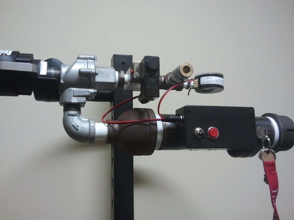

The attached image is how I rigged the valve from AutomationDirect to be NO. I am also using regulated CO2 on this launcher.
It can't really be done mechanically. I did it using a SPDT relay and a few switches. Works fine for what I'm doing.
