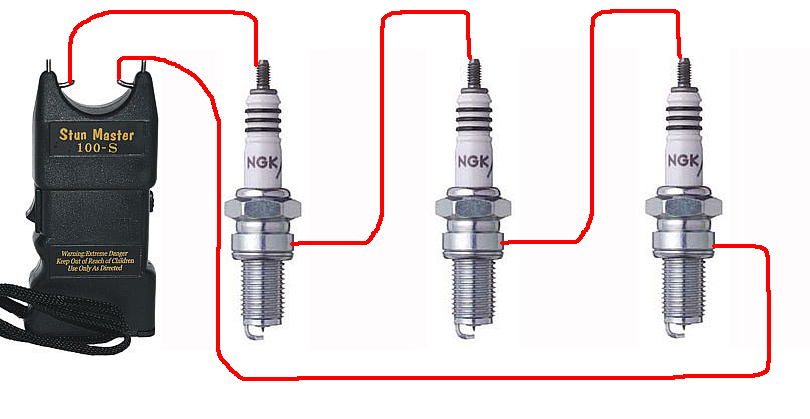

is it possible to whire them like this ? :-)

quark1980
Posts: 55
Joined: Tue Dec 29, 2009 11:50 am
Location: eindhoven
nope, only one will spark in practice, in normal applications......
each plug would need its own coil....

Crna Legija
Posts: 2333
Location: australia
natas wrote:is it possible to whire them like this ? :-)
you might need 3 + wires one for each plug but i'm no elerowizz
Has thanked: 581 times
You showed them in parallel.
For it to work in practice it needs to be wired like so, so the launcher body cannot be the ground because otherwise only one will spark.
A proper current sharing transformer between the ignition source and plugs can enable the use of multiple plugs on a grounded chamber.
This is common in lamp circuits for flat screen displays so all lamps have the same current and intensity.

natas
Posts: 122
Joined: Mon Feb 27, 2012 6:02 pm
hmm...guess im back to the first problem if i cant use the chamber as ground. :-)

SpudFarm
Posts: 2571
Hvor i Norges land holder du til?
What I would have done in your case would be to use only one spark plug and have a burst disk instead, that is if you are looking for optimal performance and not so much after ROF. This way you eliminate some of the performance loss over servral sparks as the gasses can burn almost completely before you have the disk bursting.
You could have a look on spark strips, those are fairly simple to make and creates sevral sparks.
