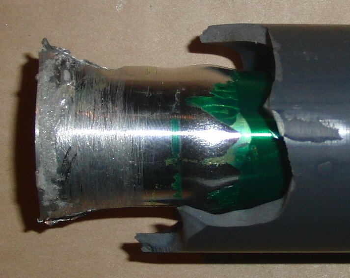

Here's an obviously failed attempt to stop a very fast and (pre-lathe) not too light "piston" with an air bumper, that's a lot of pressure to bulge the metal like that, and the space between alloy and PVC was filled with epoxy! The solution to that problem was the one I am suggesting here, a smaller diameter and lighter weight piston which made bumper material almost unnecessary.

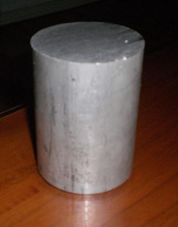

In that case, you'll be happy to know my aluminium piston has been reduced in length from ~10cm to ~9cm as Crna reckons he has a suitable piece already cut to 9cm (saves me money) :D
Damn! :shock:

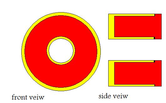

what about a air bumper like this the red part can moving the yellow part it should be a good fit, and a spring or string tied to the piston could be used to reset it.
i know you don't like air bumpers lol but others might like it.
edit, the hole in the middle is only if you have a spool type vent like your piston hybrid.
air bumper desgin.JPG (20.97 KiB) Viewed 4134 times

In that case, you'll be happy to know my aluminium piston has been reduced in length from ~10cm to ~9cm as Crna reckons he has a suitable piece already cut to 9cm (saves me money) :D :
I will machine it tomorrow
That's what, around half a kilo? Terrible :P

you will definitely have to hollow it out a lot, otherwise your pilot area will be smashed to pieces :D
I would have gone for a piston made out of UHMWPE, nylon or delrin. metal pistons are just too dense

should be 420ish grams when it done, how much is your one now MrCrowley?
