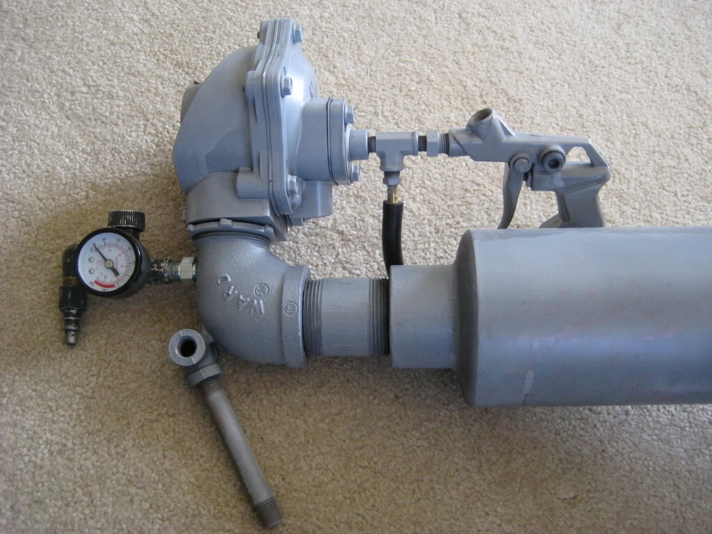

The Goyen RCA45T and the ASCO 8353H38 are very similar.

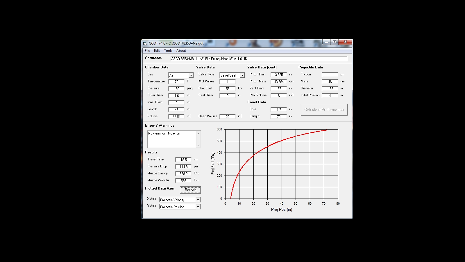

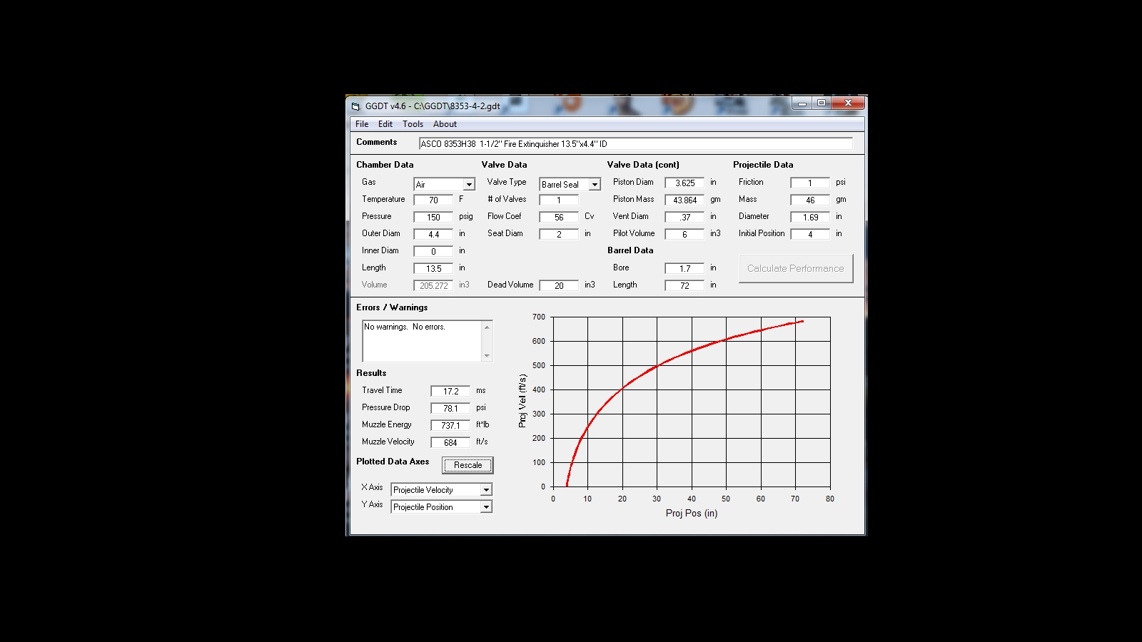

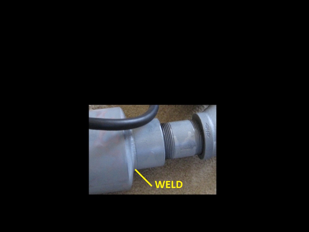

Attached are comparisons of a Fire Extinguisher chamber versus 4 foot of 1.5" pipe.
With a Fire Extinguisher you can make a much more ergonomic comfortable launcher.

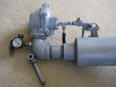

Here is what I recommend: Look closely at the street elbow, the nipple and the coupler (merchant coupling) welded to the steel Fire Extinguisher.
You will also see a 1-1/2 conduit locknut to elbow/valve to minimize the chance of the valve turning.

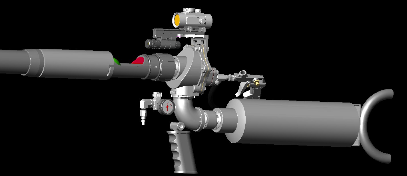

I still love that launcher dewey definatly a work of art if I do say so myself. And your cad drawings are friggen awesome!! Actually after seeing this I am going to put some golf balls into space!!!! 8) 8)

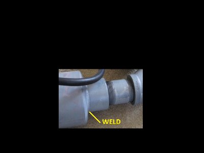

If you are using a Fire Extinquisher for a chamber, you need to at minimum, match up the hole diameters of valve input to the chamber output for optimum flow.mattyzip77 wrote:There is not anything on that cannon that is welded...
To do that, I welded a 1-1/2 coupler to the tank after putting the appropriate size hole in the tank.
