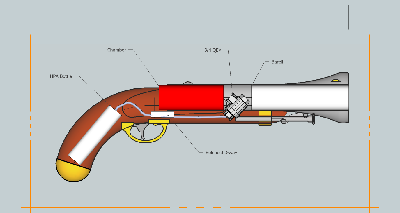

As you can see in the picture i'm considering cocking the QEV at a 45 angle, to keep the inlets to the chamber and the barrel on the flat sides of the cylinder.
Was thinking 3/4 Male NPT on the QEV going to both pipes.
Then another at the Pilot port of the QEV to get the connection there to the rear of the gun where the reservoir will be located, and the 3 way solenoid.
The gun doesnt have to be this shape, but its got to look like an overwised "pirate pistol".
I considered placing the QEV inside the chamber, so the barrell screws directly to its port sticking out, but how to get the resivoir line to it was a tricky matter.
What thoughts. What i "want" is a QEV where the two opposite ports are the chamber and the barrel, and the "side" port is pilot.
Have you considered making a preloaded cartridge?
Similar to this concept: http://www.goblinpaintball.com/
Here's a possible design, grey parts are metal, purple parts are delrin or similar high strength polymer. Everything is epoxied in place. This means it is not serviceable if something goes wrong internally, but it's so simple that there's very little to go wrong.
By using existing tubing for the cartridge body and "barrel", you'll save a lot of work and money on materials.
By using a schrader a fill/pilot valve, you don't need to build a separate fill rig.
By using high pressure, you probably won't even need a rubber seal, the delrin/metal contact should be airtight as long as both surfaces are polished and true.
You can get a 600 psi shock pump for around 55 of your finest US dollars.
