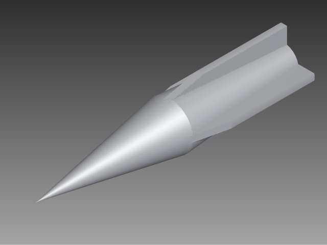

You should be able to get rid of the forward....uh.... strakes or whatever you want to call the canard-like features that are no doubt intended to keep the projectile centered in the bore. You may even be able to get rid of the aft ones too but I don't know what that would do for stability.ferret_guy wrote:After several different destines this is the one that did the best
Keep in mind you're in the barrel for a VERY short period of time and already moving quickly. After you've injected the projectile into the RAM acceleration tube, the timelines are short enough (for any project that isn't government funded, at least), that bullet "drop" is negligable, thus inertia should suffice to keep the projectile centered.

By the way, we had been calling them guidesD_Hall wrote:You should be able to get rid of the forward....uh.... strakes or whatever you want to call the canard-like features that are no doubt intended to keep the projectile centered in the bore. You may even be able to get rid of the aft ones too but I don't know what that would do for stability.ferret_guy wrote:After several different destines this is the one that did the best
I think it would be a good idea to keep the rear guides, if only because they can double as fins. I do see what you're saying about bullet drop, but it still would be nice to have a LITTLE support.

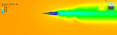

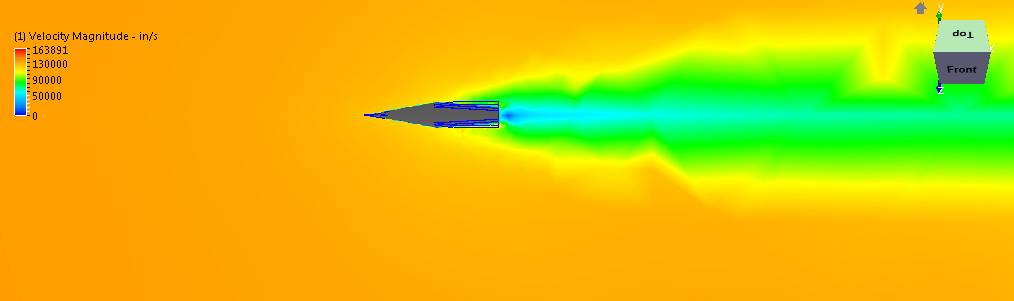

This is the latest design based on papers and my own influence and results (i will try the non stabilised one next because right right the projectile is in there for something like .00789 seconds with a 8ft tube (w/o acceleration due to combustion)

With open air flight (it too was an influence in this design)
Edit:

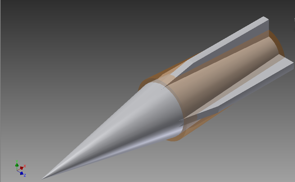

I don't exactly understand where the combustion happens in that model, given how protruding the fins are.
Also, as the barrel likely will be split into multiple pieces anyway, a much longer barrel is certainly feasible.

Highlighted areas with combustion
This is of course uper rough
Edit: finished some preliminary math from some papers I read and found out that we are talking about exit velocities hovering around mach 10 (3,402.9m/s)

Keeping the fins shouldn't be a big deal, I'll just need a salt in the injector.
Mach 10 is great, higher than I was expecting
