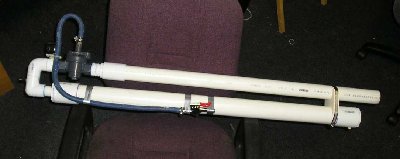

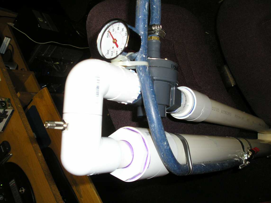

anyway i just bought one yesterday...modded it in 5mins (give or take epoxy set time) and VOILA!! works like a charm.
Posting my 90% finished gun
my 5hp 20gallon craftsman compressor only fills it to 75psi....but MAN...its WAY quieter and more powerfull than my combustion. my combustion has a 18''x4'' chamber. :O
Rear view
Rear view
Side View
Side View
