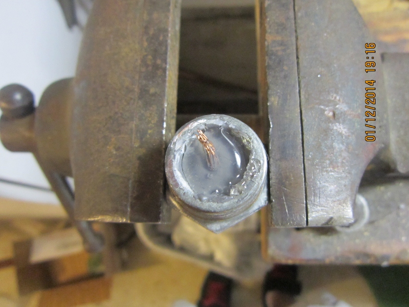

I'm just crossing my fingers and hoping it's the battery since fixing anything spark plug related is going to require actual tools. I'll test it tonight and then hopefully shoot later this week!

Well, as an update, I think I have a spark plug problem. I took all the wiring and the circuit apart from the gun and tried it with the old battery and the spark was weak, so I put in the new battery and tried again. A much stronger (louder/scarier) spark jumped across the same gap, which got me excited and optimistic. But when I tried the circuit again attached to my spark plug, I got the same weak, squealy spark.
So now I have to take apart the spark plug and do something with it; I can't even tell what exactly is wrong. All I know is that it's gonna be a pain to redo since there's probably 15 mL of JB Weld holding the wire in place. Maybe I just need to use something else for the electrode, like a bent screw or a paperclip?
Time to find someone who has tools...

Before completely redoing the spark plug, I would take some very fine sand paper to both sides of the spark gap. Also check that the connection to the ground pipe (and any other connections) is (are) good. Are any of the pipe joints the current passes through taped with teflon tape or pipe dope? How big is the spark gap? Smaller is often better.

The problem is that I can't diagnose the problem without taking the spark plug out. The problem with taking the spark plug out is I don't have any tools. The fix itself honestly shouldn't be too hard, I can always throw something together as a short term solution until I have access to my bench at home.
I have a bad feeling that my copper wire electrode might have been burnt off by excessive amounts of stun gun zapping. I'm glad the circuit is fine though; that was my biggest worry until I replaced the battery.
I feel like having a more solid steel electrode might be better than copper wire...

In the pictures it looks like the wire is probably not high voltage insulated. Could the charge voltage be bleeding off through the insulation especially since it is in contact with metal much of it's rather long length? At least that is something you can check without taking much apart.

The insulation is stripped off the part of the wire that's submerged in epoxy.
I really don't think that's the problem though. I'm positive it is something electrode-related just because the gun was firing perfectly every single time at home, at my friend's house when I came back to school. The gun sparked perfectly, I put it in his trunk, and when we took it out the next day, it had the spark problem. Therefore the problem must have occurred in the trunk! And since the circuit works fine by itself, not attached to the spark plug, but fails when attached to the spark plug, I'm positive it's something to do with the electrode.
I'll update this topic when I get the spark working again. Worst case scenario it'll be around 2/15, since that's the next time I'm going home. Until then, it's not worth speculating about.
oh... when you said "spark plug" I assumed you meant an automotive spark plug.
This is definitely far from ideal.

I like to use automotive type spark plugs. I found that you can get a 'VA21140 Vermont American 21140 Metric Plug Tap, Sparkplug, 10mm - 1.00mm' from autotoolworld.com for $5 plus shipping and then use a 10 mm threaded spark plug. I have been using NGK 4628 (C7HSA) spark plugs that a local auto parts place stocks.
Oh and I usually would have put the spark plug where your fill fittings are and vice versa. If you later convert to a piston valve, which I think you mentioned earlier, the plug would have to move from where it is now anyway.
As I mentioned, most wire insulation is not meant for the kind of voltage your stun gun puts out, not even close. Even the high voltage stuff I have found is technically not rated for that. I use high performance copper spark plug wire, but it is kind of expensive and I had to buy a full set of wires. A cheaper work around might be to sleeve your wires with silicone or rubber tubing.
Probably not a big deal and I may be wrong but I think it is better for the flame to burn toward the barrel. Someone did some tests and I think they said that with a single gap the best performance they found was with ignition a bit farther away from the barrel than the mid point. I don't like to drill the pipe so I just drill and tap the end cap and that puts it all the way away from the barrel.
Again, that is all personal preference so it may not be the optimum setup. I just present it as food for thought.

Well of course i gotta throw my 2 cents in now!!! Just like a typical spark the spark gap should be just barely open. You could use a feeler gauge to set it to just a few thousandths. Also the gap, electrode, must be super clean from debris. If that don't work change the plug.

Yo noname!!! One more thing.... i wouldn't worry about it being a wire insulation problem. If ur using a tazer for a source, and ur wire had real basic insulation on it, it would still produce plenty of voltage for ignition. U would have to have a dead short or a break in the circuit to not get spark. It is agood idea to get the hi current insulation wire just so u get all your supply to ur electrode s. Being a commercial electrician i deal with similar things.
