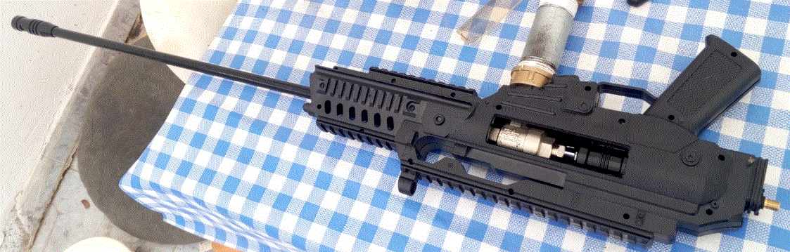

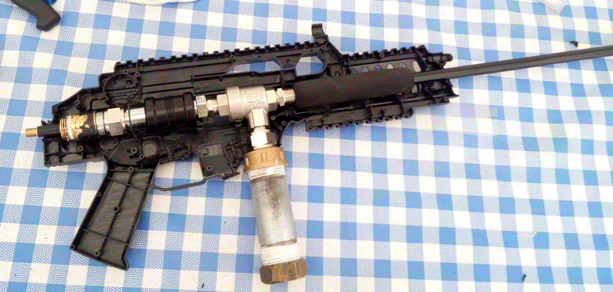

So i was at the local market yesterday and i saw this toy gun for 5$..I was thinking, why not use it as a housing for the 10mm i planning? :idea:
so i got it, did some modification on it (space for the valves, triger, breech loader ext..) and i think this could actually work, it came with a plastic detachable stock (not in the picture) and i was suprised to find the rails are compatible with picatinny rail mount :)
solution for the lazy :bigsmurf:
Re: QEV+Slide Valve multishot (Airforce Condor style)
Posted: Sun Apr 09, 2017 1:15 pm
by Anatine Duo
That's a good looking conversion
Posted: Mon Apr 10, 2017 5:33 pm
by encohen
thanks man

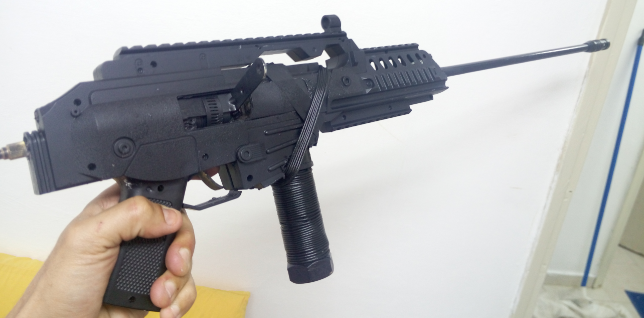

It's pretty much done now. only took me about 2 hours to make it.
features:
3/8" QEV (added a spring)
3/8" Slide valve
1"X10cm (50cc) air chamber
10mm diameter, 25" long barrel (blow gun barrel)
I removed the insides and cut some of the plastic, after putting everthing in, i used some expanding foam to fill the empty spaces & make everything stay in place. I drilled a 10mm hole in the barrel (right next to the QEV) and used a tube with a handle to seal it, attached a trigger and a reloading handle to the slide valve, and that's it. it's pretty light and surprisingly easy to aim, shoot & reload. I can't find the detachable stock though :oops: .. if i won't find it I'll just get another one from the market (the whole rfile kit was less than 5$) :shock:
power: the 63 grains bearing ball did penetrate 1/2" plywood from 10 meter away, but it doesn't feel as powerfull as my 15.5mm rifle (probably due to the smaller chamber). not sure what's the acttual velocity though - gotta get me a chronograph :!:
accuracy: still waiting on a 2.5-10X40 scope for it, but I did get some nice 1/2" groupings from 10 meter away.
shots per fill: I got 53 shots (by that time my tank was down to 500 PSI) - not to bad, could get better.
to summarize, I was really skeptical at first.. My original plan was to build a wooden stock for it.. but it turned out better than i anticipated, it saved me tons of work, and I allready got my 15.5mm rifle with a wooden stock :lol:
I can probably make it a bit better looking..got bored and wraped some paracord on it

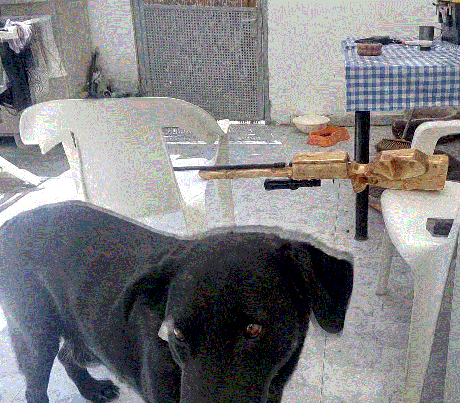

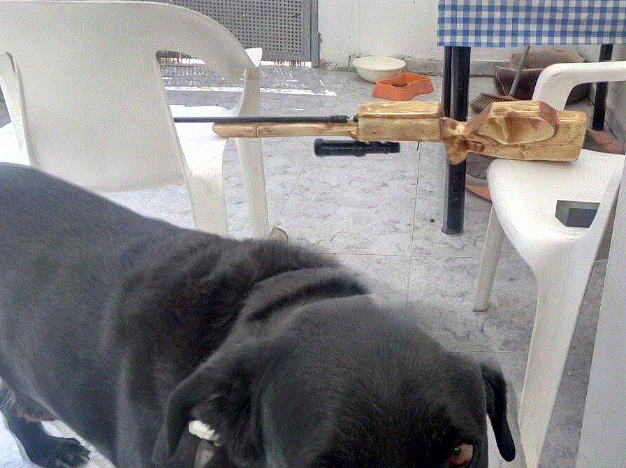

anyway, I'm almost done with my new 10mm rifle. the stock isn't as nice looking as I wanted it to be, but it's practical and I added a pressure guage behind the air chamber. The rifle operates smoothly with 550 PSI. I was also able to get 400 10mm bearings ball for about 20$. I'll make a new post with a video on both rifles soon
