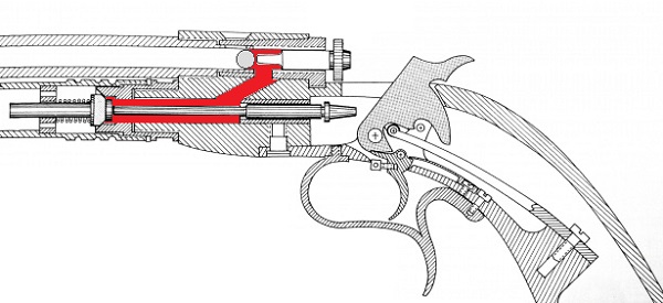

This 1400 has languished in my parts bin for some years now, I'm wondering if it could be a candidate for a much more radical project.
Here is roughly the concept I have in mind:
The "blow open" idea and trigger are preserved, but the chamber and valve are moved in line with the barrel, and instead of a bolt the pellet is loaded via a sliding breech.
This geometry should make it much more efficient, much less dead volume and with a balanced spool, the transfer port can match the caliber for greater flow without undue pressure on the trigger. Hopefully therefore I would be able to up the caliber to say 0.30" and still have useful velocity.

It looks good and I think it's an interesting adaptation. I'm not sure how a sliding breech works...
Re: Crosman 1400 Pumpmaster 0.22"
Posted: Wed Nov 29, 2023 1:48 pm
by jackssmirkingrevenge
hectmarr wrote: Tue Nov 28, 2023 5:24 pmIt looks good and I think it's an interesting adaptation. I'm not sure how a sliding breech works...
Think of it like the Huben K1 whose magazine feed functions on a similar principle:
The projectile is placed inline with the valve and the barrel for minimum loss and maximum efficiency
This is in contrast to the "traditional" configuration with precharged guns where the gas needs to fill up considerable dead volume and reverse direction, which yields significantly lower efficiency and reduces power potential.
